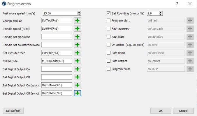

In the window (attached below), how do I trigger a digital output to ON at the start of path and turn OFF at the end of the path.

I create G codes and use M codes for digital outputs. I use M%1 and call program. These subprograms called M... contains makros, digital i/o on/off.
If you go by apt you can insert code directly and it will be formatted correctly into robodk.
Elseif
you have imported an actual curve form a cad system, I recon the path will be just that and you can use path start and finish. <- never tried this myself

Thanks for sharing your insights. Could you please let me know how can I generate M codes for a certain 3d object made in SolidWorks? Afterwards, how can I incorporate those digital I/O commands in the M code in a way RoboDK can understand?
You should be able to activate the Path start and Path end event triggers and select the plut button (+) right beside the name of the program you want to run.
There you can enter custom code output that will be exported when you generate the program.
