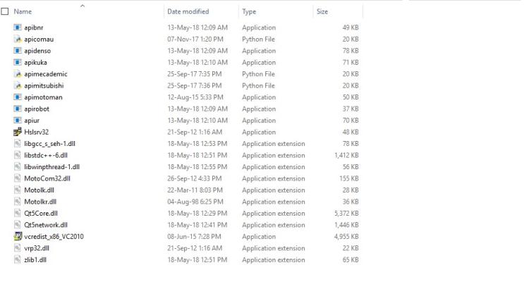

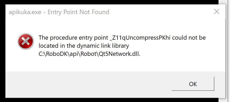

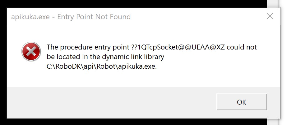

Where I am currently stuck is with testing the robot driver. After being prompted to install numerous .dll filles, as well as vcredist...exe, I still get two errors when opening either apikuka.exe or apirobot.exe in C:\RoboDK\api\Robot.
I have attached relevant screenshots.

After lots of deleting and re-downloading .dll files I finally resorted to reinstalling windows on my computer.
It's now working!!
I guess some of the .dll files went missing or got corrupted during my last OS install
