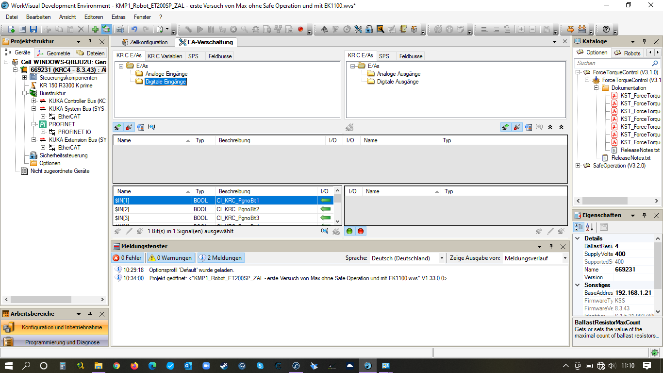

Robot-IP: 192.168.1.21, see bottom right
When connecting to the robot, I tried both IPs, but I have no idea what connection number I need. There was a 7000, what does this number mean?

Wov is seperate from rdk, you install the drivers on the robot directly, goto the network settings and find the ip of the robot, 7000 is the port address
