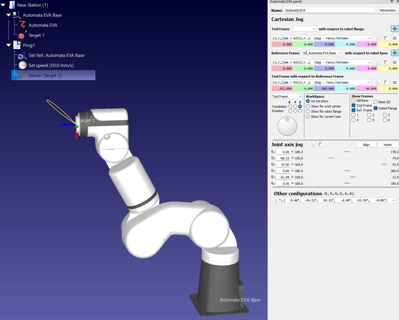

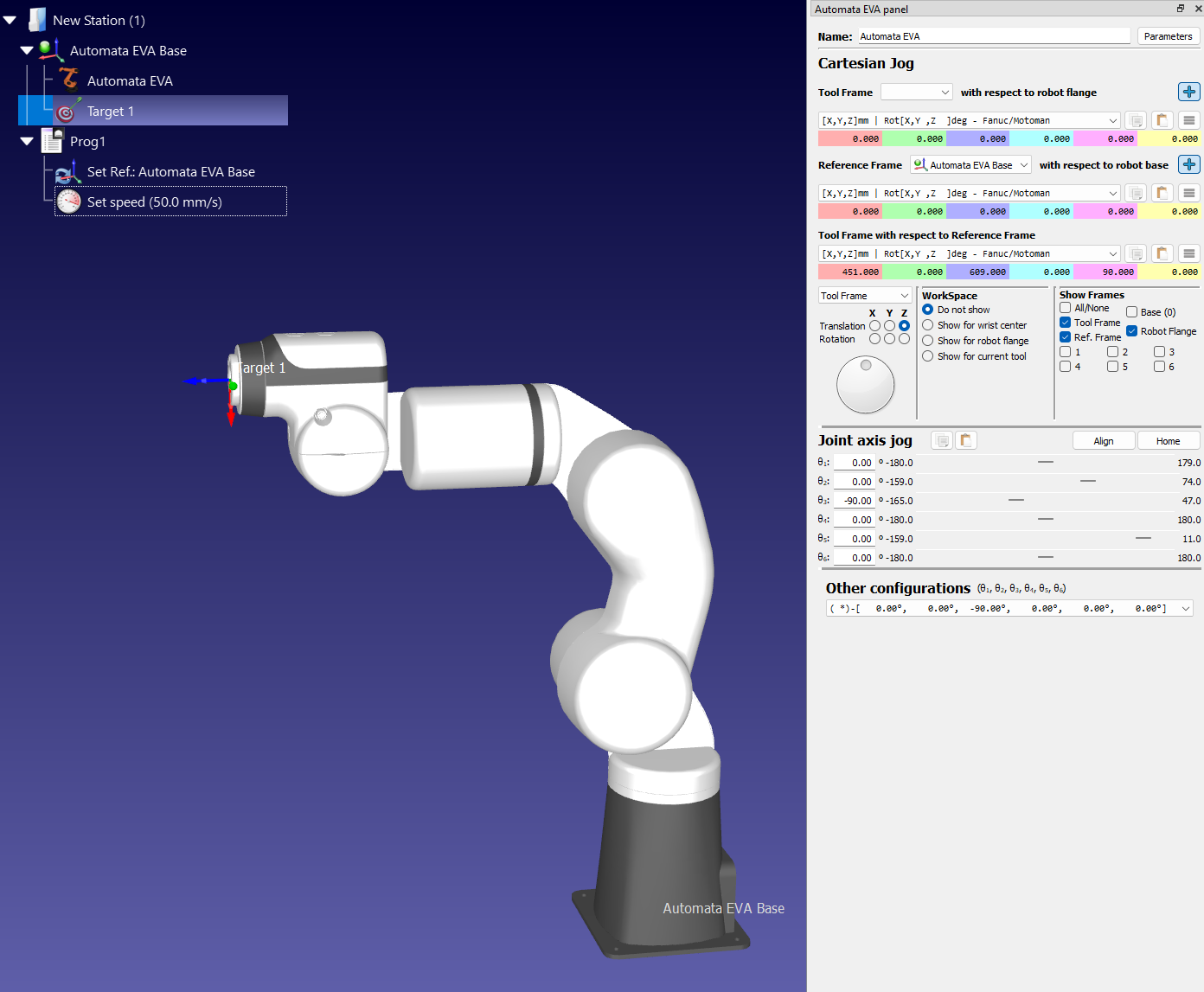

The EVA model posted by Olivier on 07-05-2025 is still behaving strangely when teaching targets and movements. While the axis values are correct during jogging, the robot's position becomes inaccurate when teaching targets and movements (it flips Axis 3, causing all axes to go non-optimal).
The attached pictures illustrate the issue:
  • When homing the robot and teaching Target 1, everything appears to be fine.
  • However, when adding a MoveJ command to Target 1, the robot's position becomes incorrect.

I contacted by email and got response 15.5. that my request is forwarded to Support Team. I haven't heard anything after that. I know this is not maybe priority number one on your list, but I think we are really close to get EVA working. Just (minimum) Axis 3 flip correction and could use EVA + RoboDK in our lab exercixes. Axis 3 degree range is now right in RoboDK, but path planning is broken and robot pose is wrong after moveJ command in RoboDK (previous post images).
