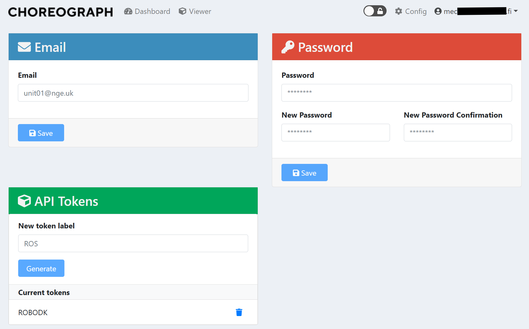

How do you retrieve the API token? I assume this is different from one robot to another?
(04-22-2025, 03:17 PM)Albert Wrote: Excellent, thank you for letting us know.
We'll update the post processor accordingly and add a parameter to easily configure the API token.
I think tokens are always different (User/Robot). I attached a PDF of documentation for API token generation and a screenshot of EVA UI. There is still some problem with generated joint values (robot maybe expecting radians?), but I haven't had time to test this enough. Will do more testing next week.

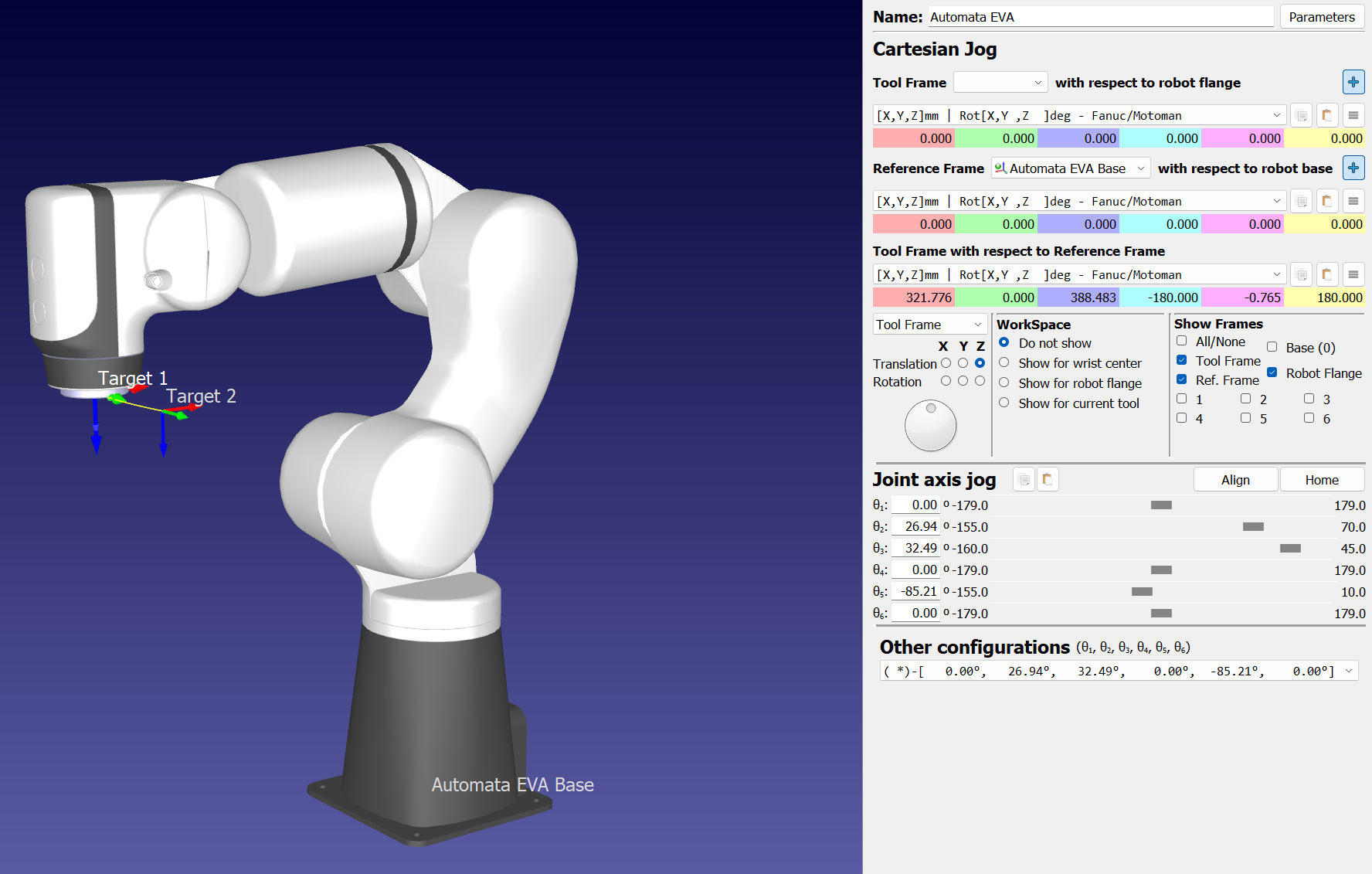

With quick testing, when generating a robot program from RoboDK, the joint values are in degrees:
robot.MoveJ([0.000000,26.941900,32.492400,0.000000,-85.214100,0.000000])
robot.MoveJ([16.526600,22.812800,29.575700,0.218710,-83.970100,16.502200])
This results in the following error:
control_go_to error: status code 400 with error [{'error': {'error_code': 0, 'title': 'Toolpath error', 'details': 'Go to generation error: Motion error (Joint 2 Boundary Limit: Joint 2 hit boundary limit.)'}}]
[16.5266, 22.8128, 29.5757, 0.21871, -83.9701, 16.5022]
control_go_to error: status code 400 with error [{'error': {'error_code': 0, 'title': 'Toolpath error', 'details': 'Go to generation error: Motion error (Joint 1 Boundary Limit: Joint 1 hit boundary limit.)'}}]

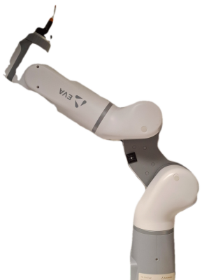

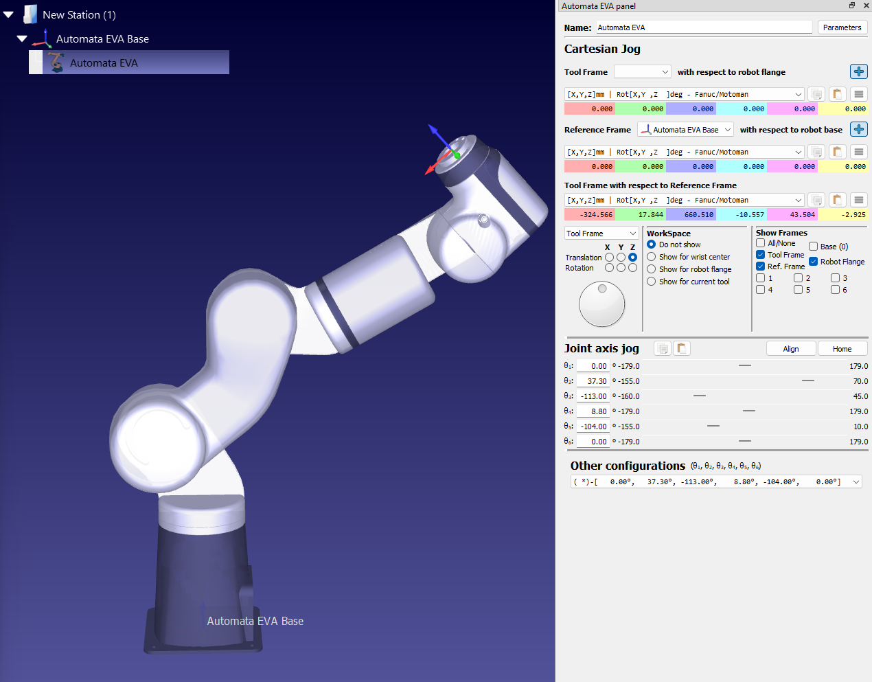

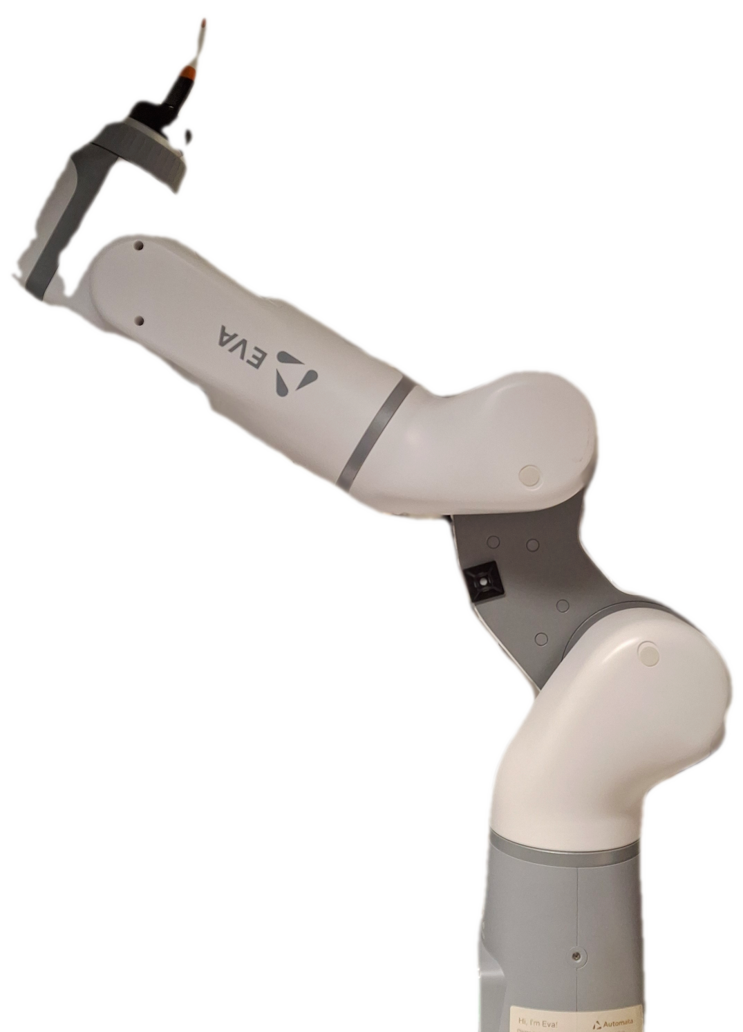

When converting these degree values to radians, the code works, but joint 3 flips to the wrong side of the robot. It seems that negative values correspond to the "front" side and positive values correspond to the "back" side for joint 3.

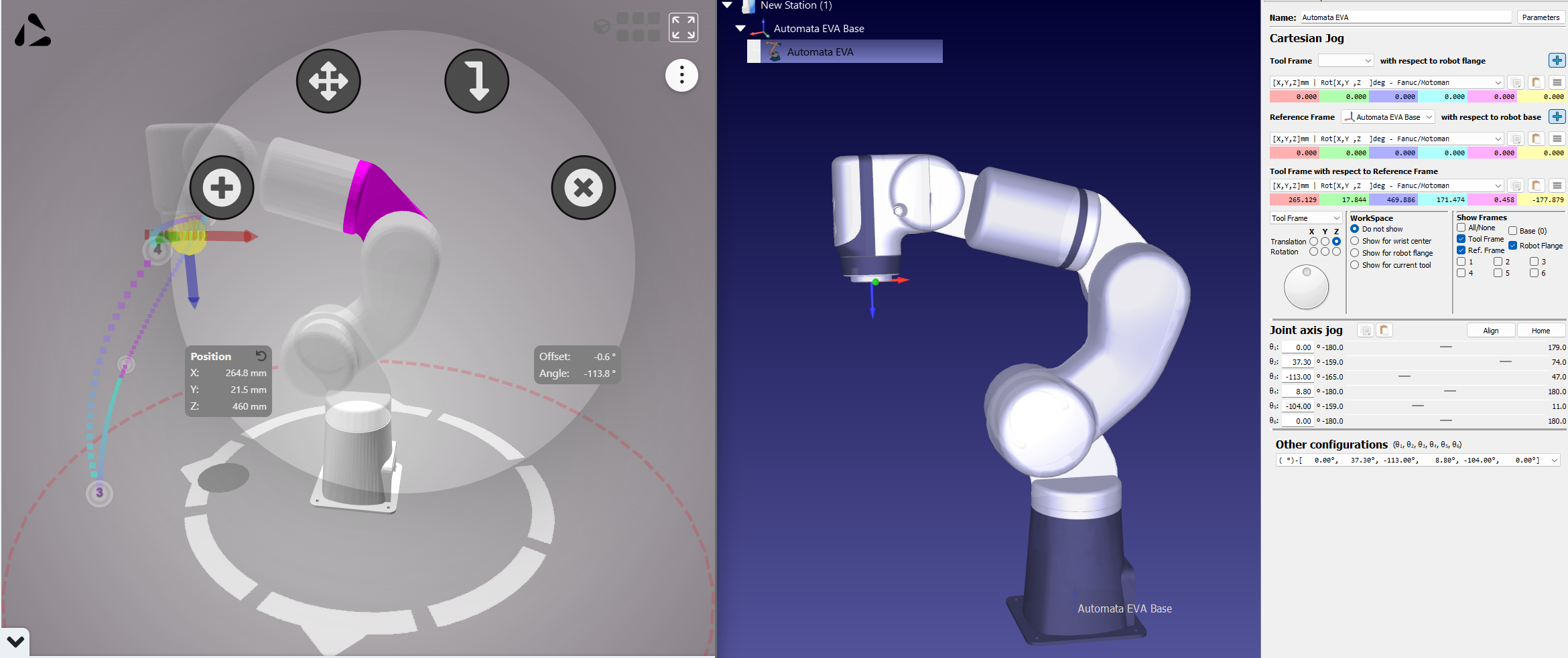

(05-07-2025, 02:11 PM)Olivier Wrote: Can you test this version and confirm that the joints senses are correct?
This version of Axis 3 works correctly in RoboDK axis jog when compared to Automata Choreograph. The robot positions are the same in both visualizations (see pictures). Thank you!
Also connection from RoboDK to real robot is working when replacing API_TOKEN = "ROBODK" with real generated api_token. Thank you!
eva_python_sdk is still waiting for radians for axis angles so getting error when trying to run program on real robot.
Also this new EVA robot model does make weird moves in RoboDK when trying to teach targets and movements... but this was still work in progress? All my targets are unreachable.
