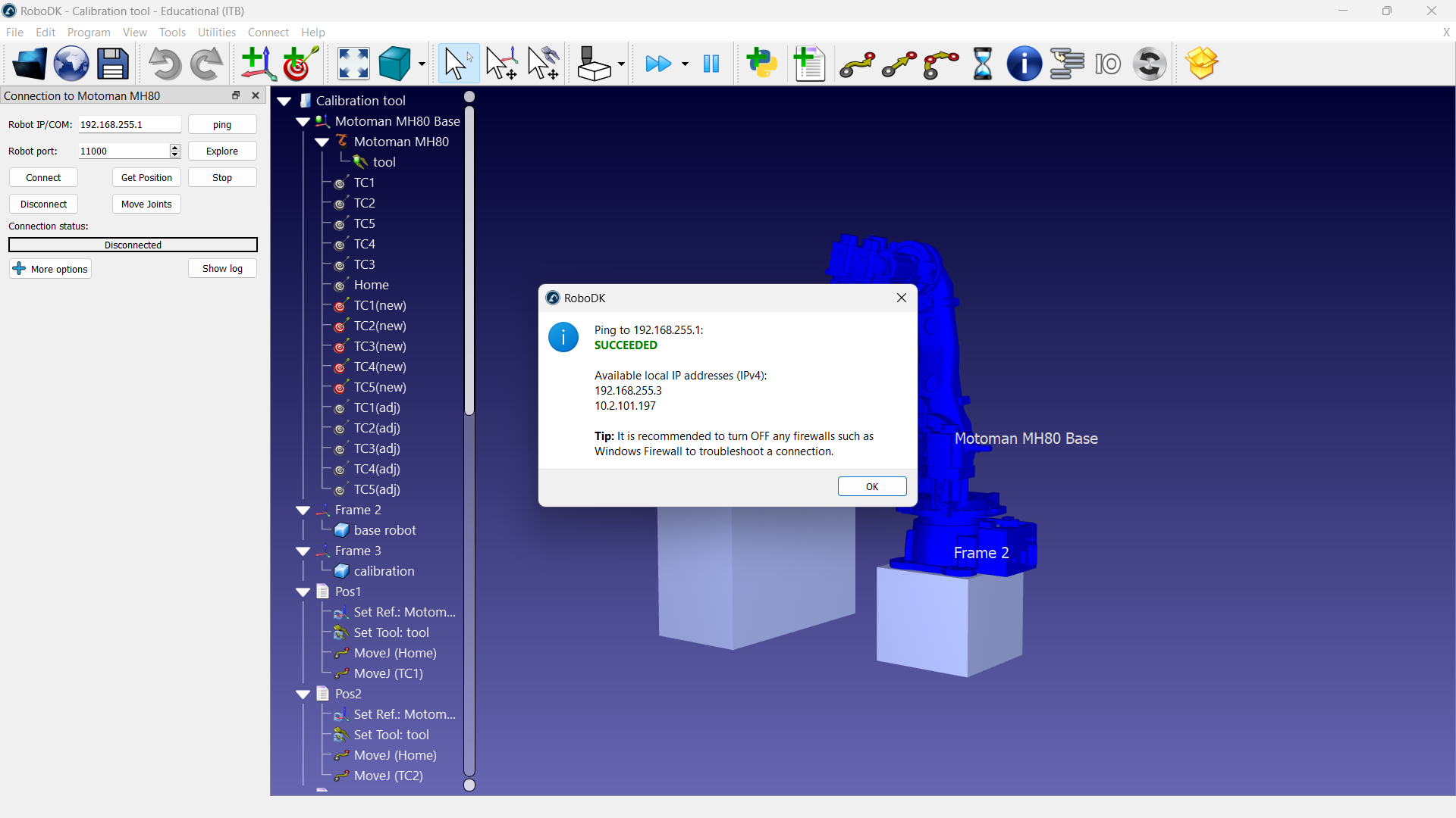

i did ping the robot. here, i tried again to connect robot motoman mh80 dx100 with Motoman HSE. it seems doesn't work and give this log. is there any solution about this?

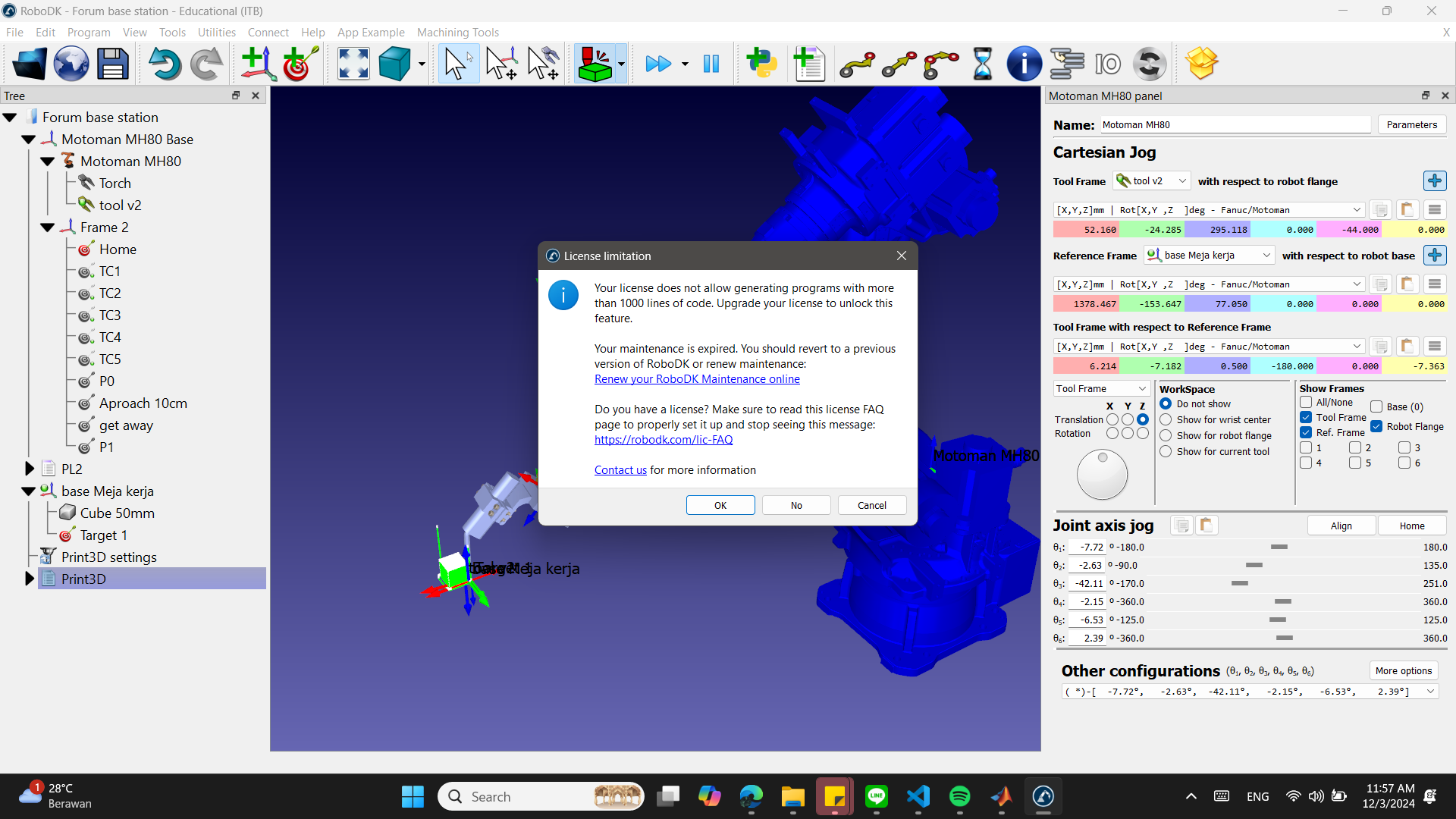

and additional question. i have project that use the robot for 3d print. i made a simple 3d print project and wanna generate the code. when I generated it, it poped up massage that it beyond the limit in code (which is the limit 1000 lines code) and my maintenance is expired. i just renew my edu license like 2 or 3 weeks ago. whats the solution for this? please help me.
