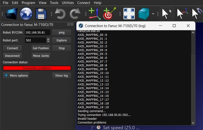

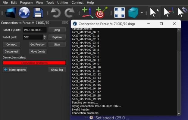

I was trying to send my robot program from RoboDK to the Fanuc M-710id/70 robot and keep getting the error message: "[WinError 10060] A connection attempt failed because the connected party did not properly respond after a period of time"
Even though I have turn off Window fire wall and I can also ping the robot from RoboDK, the error persisted. In the log it said: "Invalid header" and "Connection problems".

It looks like you are trying to use the driver to move the robot from the computer. I recommend you to generate programs offline instead and send them to the robot (right click on a program and select Generate program).
If you still want to use the driver, the WinError 10060 you are encountering refers to a connection timeout, often due to network or port configuration issues. Double-check the robot’s TCP/IP settings and confirm the network allows communication on these ports. Although you have disabled the Windows firewall and can ping the robot, also verify that no other security software is blocking the connection.

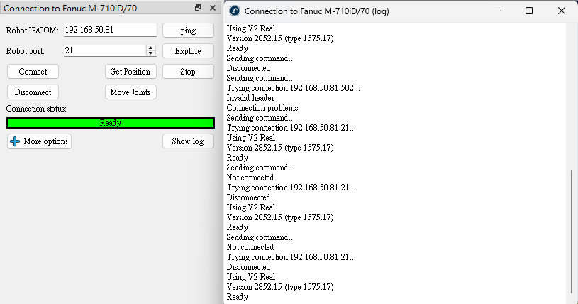

So I followed your advice to generate the program first then send it to the robot. But now I am having another error that is: "530 login incorrect"
The attached images are the error message alongside with my log when try connecting to the robot

The "530 login incorrect" error usually means that the username or password used to connect to the Fanuc robot using FTP is incorrect. Please double-check the login credentials you are using in RoboDK to connect to the robot controller.
You can enter the FTP credentials by selecting More Options in the robot connection options.
