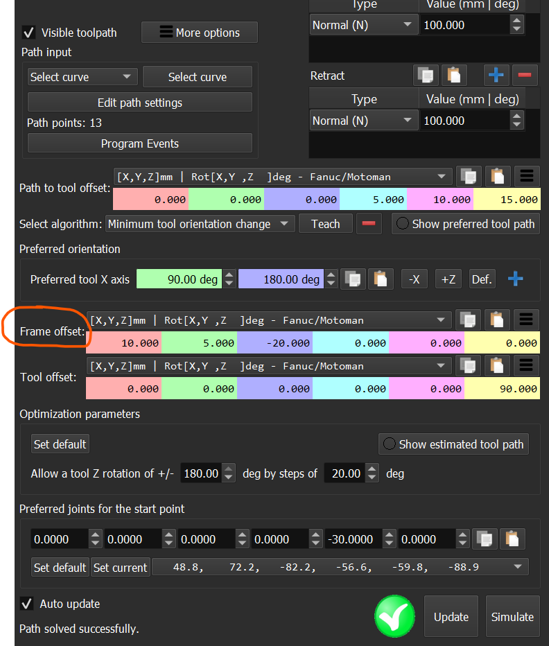

I'm wondering how to set the "Frame offset" coordinates for a curve follow project. I know to use `project.setPose` to set the "Path to tool offset " coordinates and `project.setPoseTool` to set the "Tool offset" coordinates, but how to I set the "Frame offset" coordinates via the API?

Thanks Albert. I tried your suggestion and it still throws a TimeoutError at the `project.setPoseFrame` line. I've had success with the `setPoseFrame` method when I pass an item of ITEM_TYPE_FRAME in as a parameter, but when I try to pass a pose (robodk.robolink.Mat) it throws the TimeoutError
