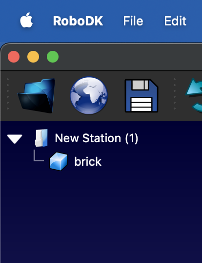

Crashes after clicking on Change colors
On Mac Os 15.5 (apple m4),
after adding any stl, when clicking on "Change Colors" (right-click on my stl -> Options -> More Options -> Change Colors)
RoboDK crashes
* changing color from api works
Can you share the RoboDK project file that you used to see this crash?
(07-06-2025, 09:34 PM)Albert Wrote: Can you share the RoboDK project file that you used to see this crash?
For some reason, I can't save the project with the stl file inside. After saving, it turns out to be empty.
In fact, this is a really empty new project. I just add an stl to it, like this one (attached), and then try to change its color.
If you want to see the model itself, just scale it to 1000 (although this has absolutely no effect on anything)
This happens with any stl file.
Moreover, everything was fine before, and specifically with brick.stl
If necessary, I can record the screen.
And
just in case, I'm attaching a crash message.
