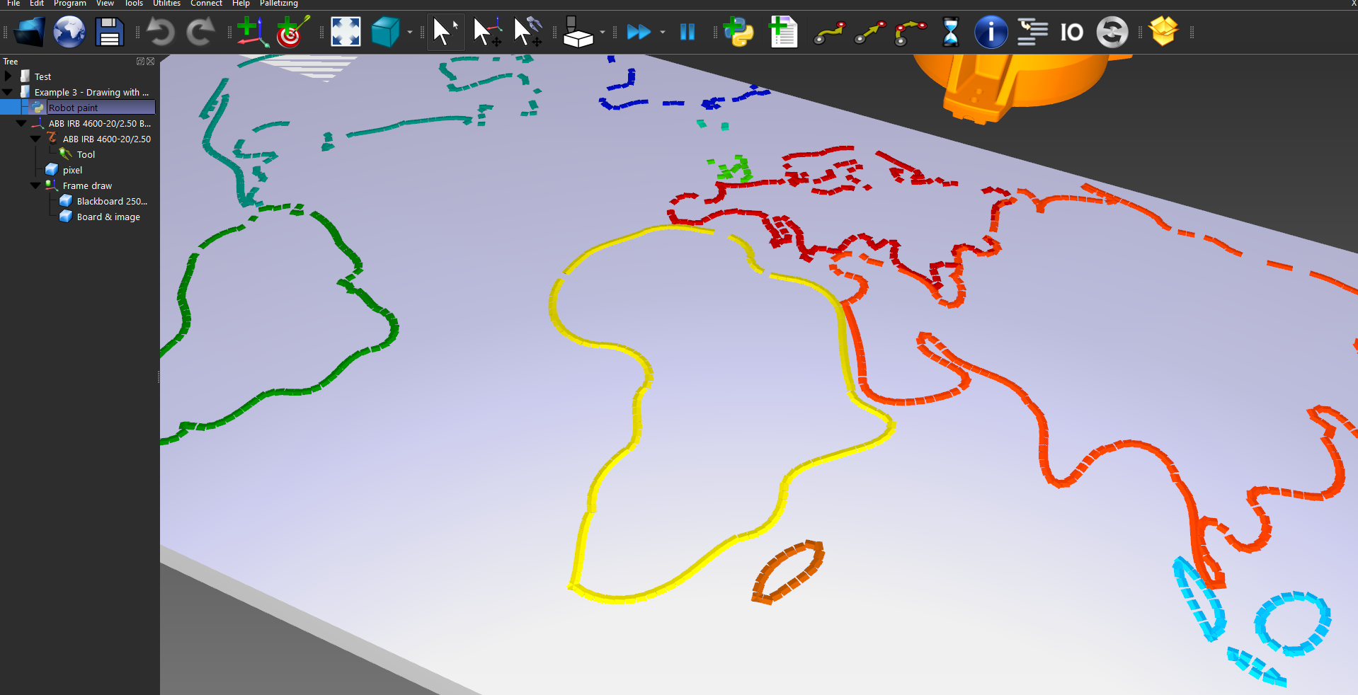

The outcome should look similar to this drawing example but with simpler, sphere-like particles.
