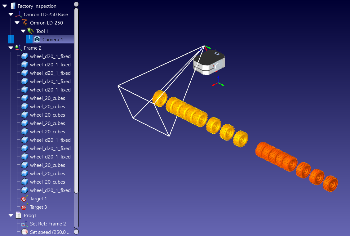

I am working on a part inspection syste. Is there a possibility of creating a video from the camera feed. I am assuming we can do it from the RoboDK API? factory inspection macko.png
Screen Shot and .rdk file attached.

We have an add-on called the Record App which allows you to attach a camera to any object and create videos from it. You can find more information here:  https://robodk.com/addin/com.robodk.app.record
I believe adding a "Record" camera to Camera 1 and making sure the camera settings match should allow you to easily record what Camera 1 is seeing.
Hope this helps!

Thanks Yann, very much appreciate it.
