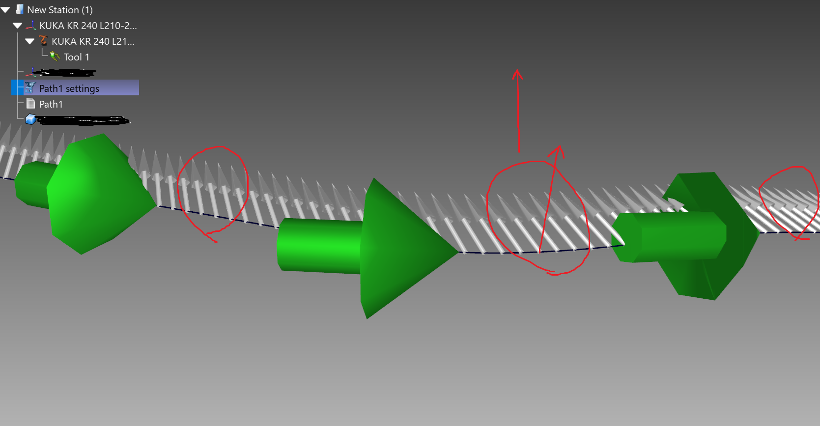

Curve follow path Problem |
09-17-2024, 08:33 AM
You can use the curve utilities addin for better control over curve points and normals:
https://robodk.com/addin/com.robodk.app.curveutilities You can also select Curves-Modify curve to modify the curve. Can you share your RoboDK project file? We can help you better.
09-17-2024, 10:24 AM
(09-17-2024, 08:33 AM)Albert Wrote: You can use the curve utilities addin for better control over curve points and normals: Thanks , my problem solved with Curves-Modify curve. |
