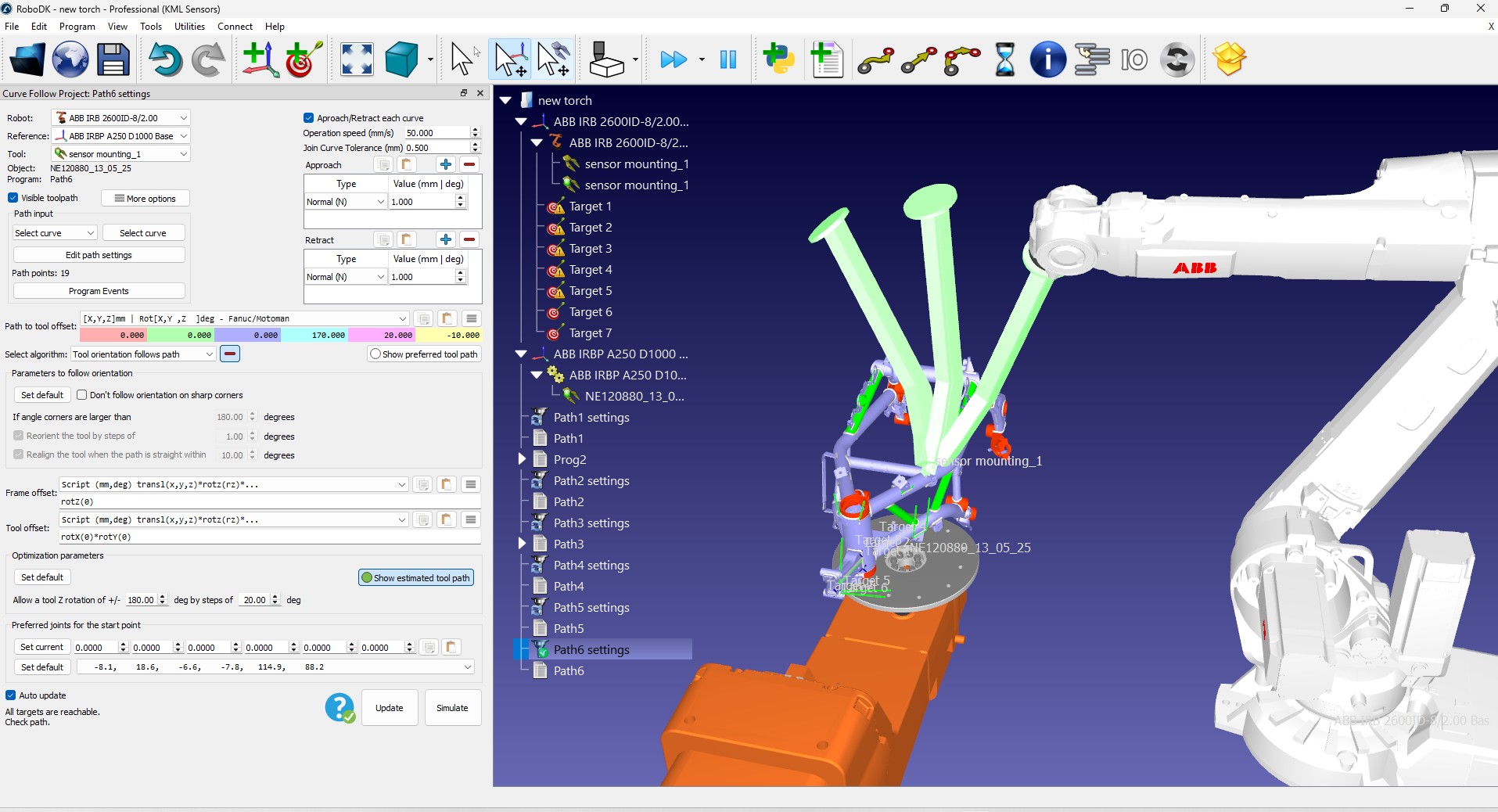

In curve follow project i am selecting 2 curves on single curve project. both curves are having different orientation. if i add offset both are going on different angle. how to maintain constant tool orientation on different curves? suggest some settings.
Are you referring to the Z axis of the TCP or the rotation around it?
Can you share your RoboDK project file? We can help you better.
