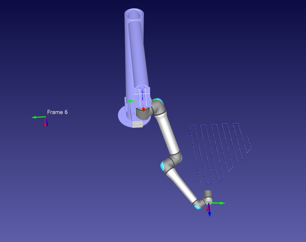

When moving my curve between to different reference system, the points are not updating.

The coordinates you see are usually relative to the coordinate system of the parent item your points or object is attached to.

is there a way, so it update them like Targets then?

Yes, you can move the object points, curves and geometry by double clicking on the object, select More Options, and enter the pose you want to apply to the object.
