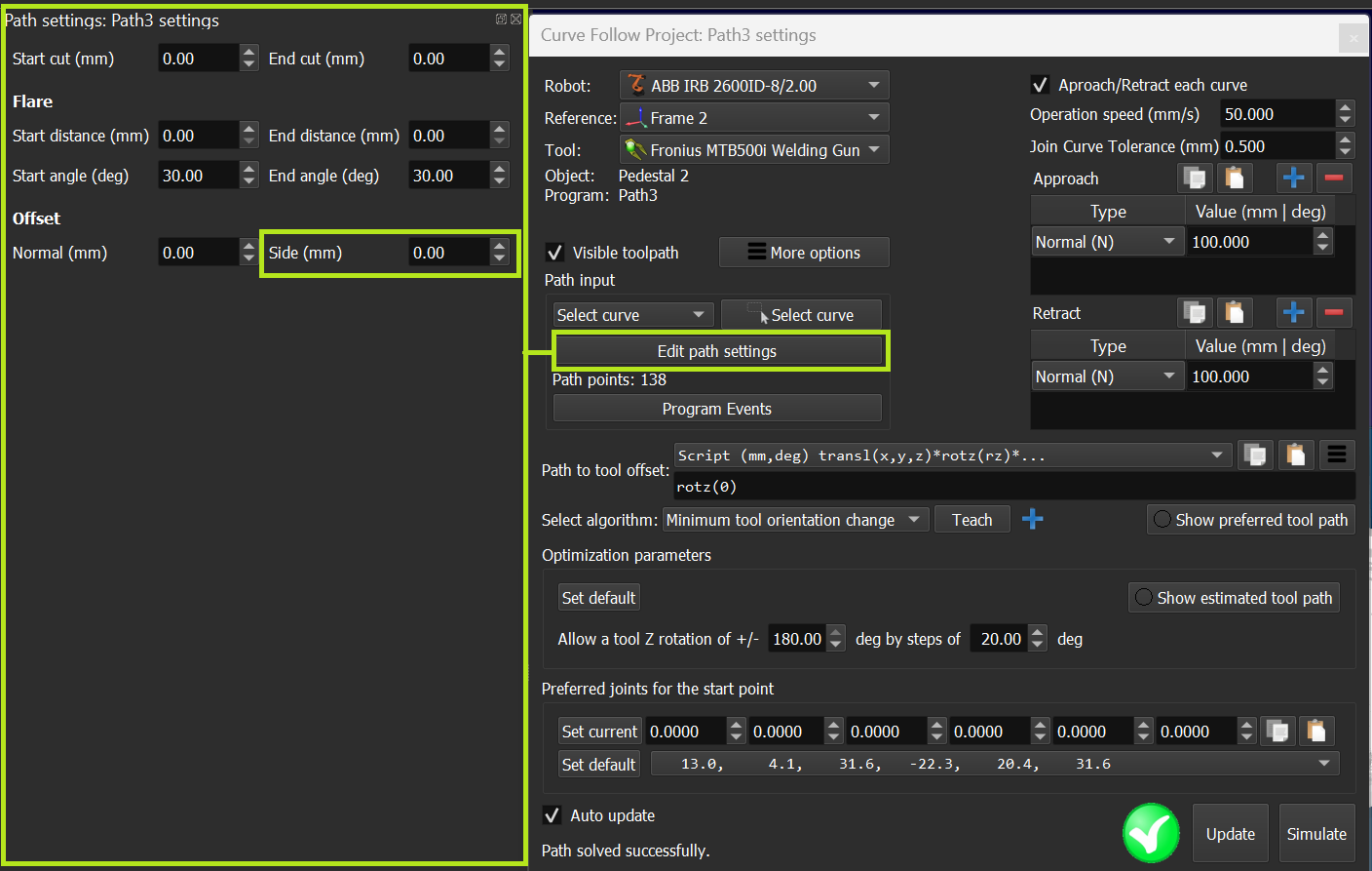

In RoboDK you can apply offsets to the trajectory if you use a curve in CFP:
In the case of using an NC file in CFP, "Path Settings" is not applicable, but you can adjust the TCP value for the cutting point offset.
