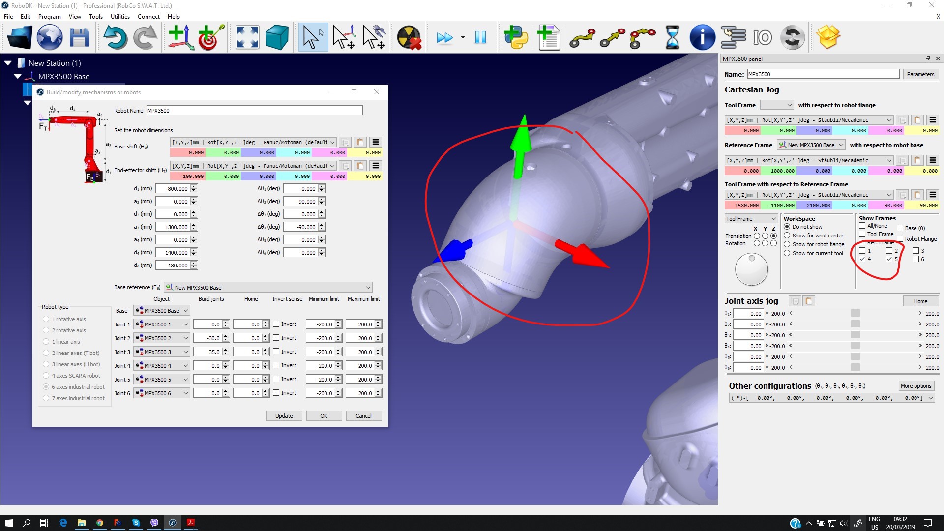

Custom robot config axes
Hello i'm building motoman robot and have question about 4,5 joint
How to offset 5 by 4 and rotate it to align with geometry
Hi gmarinov,
The robot you are looking for is kind of special. I don't think that you can add it by yourself.
If you have a professional license, which you seem to have looking at your picture, you can send us an email (RoboDK->Help->Request Support), add the 3D model of the robot and the datasheet with the measurements and we will be happy to add it for you.
We usually do that within 2 to 4 business days, unfortunately it will take a bit more than that this time because our engineer in charge of that is out of the office for a week.
Have a good day.
