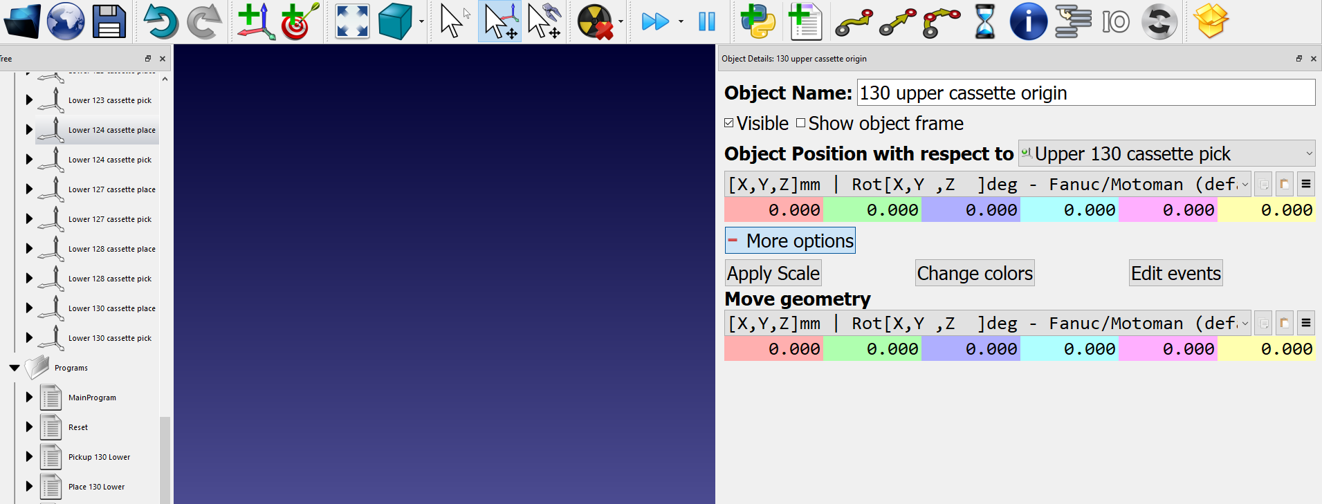

Hi I have a strange problem. I haven't intentionally changed any setting but the text size of my options windows that you can open with F3 on any object or item is suddenly huge to the point where the software is almost unusable as it takes up almost the entire workspace.
I can change the size of text in the tree and the icons toolbar from the Tools-Options menu but these seem to be unrelated parameters.
I'm sure it's a simple fix but need some help.
Thanks

I've just emailed you as well but I can confirm that the scale factor isn't helping as it rescales all text as opposed to just the text in the F3 options and toolbar.
The text in the tree and the standard Windows window text (File, Edit etc.) are not affected.

I don't actually run a 2nd screen on this laptop. Do you think I need to reinstall?
Try this first:
Close RoboDK
Go to C:\Users\XXX\AppData\Roaming\RoboDK
Delete the content of the folder.
Restart RoboDK
Great thanks! That did the trick. It seems strange that my layout settings changed but just glad to be back to normal.
