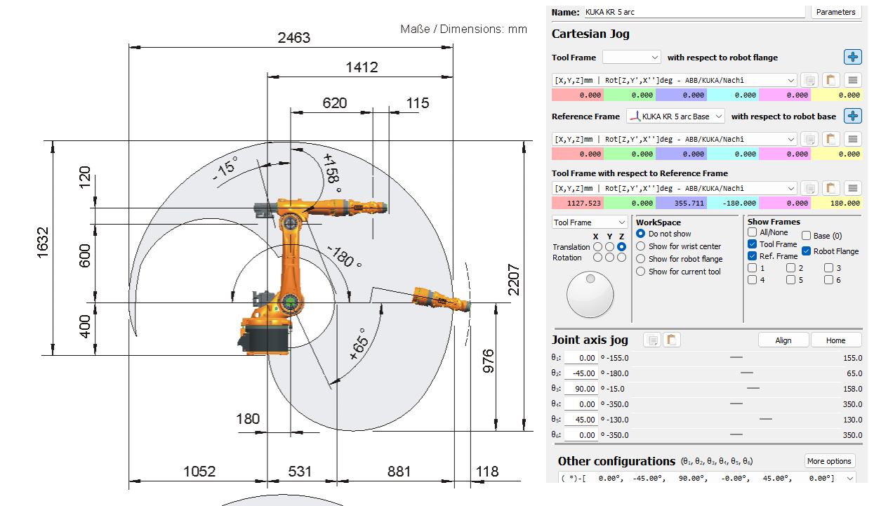

I've seen that similar questions were discussed earlier, so I hope there is someone here who can help me understand why there is a difference between calculation of the TCP using DH parameters presented here:
Understanding DH Parameters using KUKA KR5 Arc Industrial Robot
When I load this robot in RoboDK and perform axis jog for these joint angle values, I get different result even though the first component X is the same (scaled to mm from meters).
I used the following py script from robotics toolbox to do calculation:

print("This is from RoboDK")
T = SE3.Trans(1127.523, 0, 355.711) * SE3.Rz(-180, unit='deg') * SE3.Rx(180, unit='deg')
print(T)
