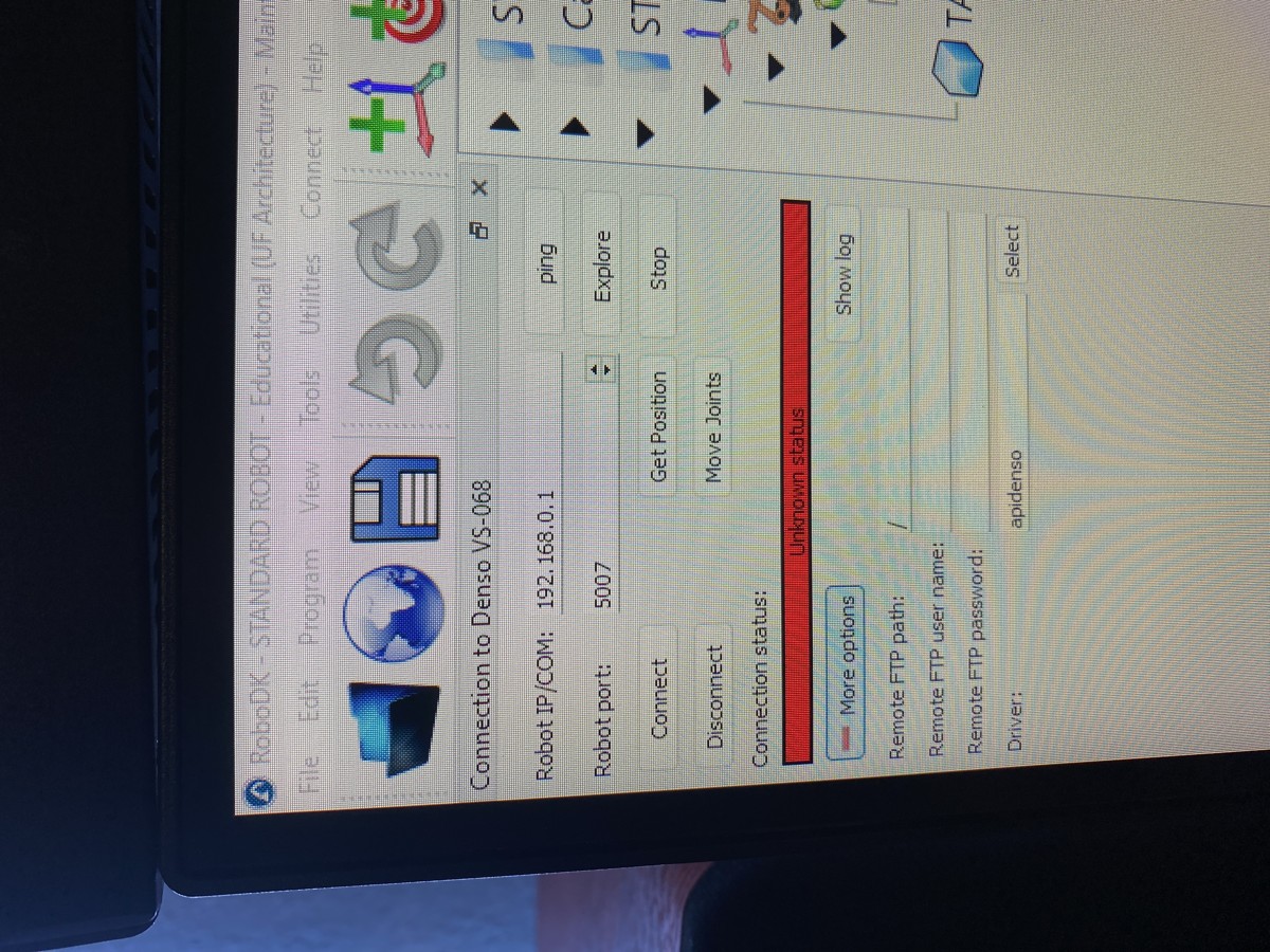

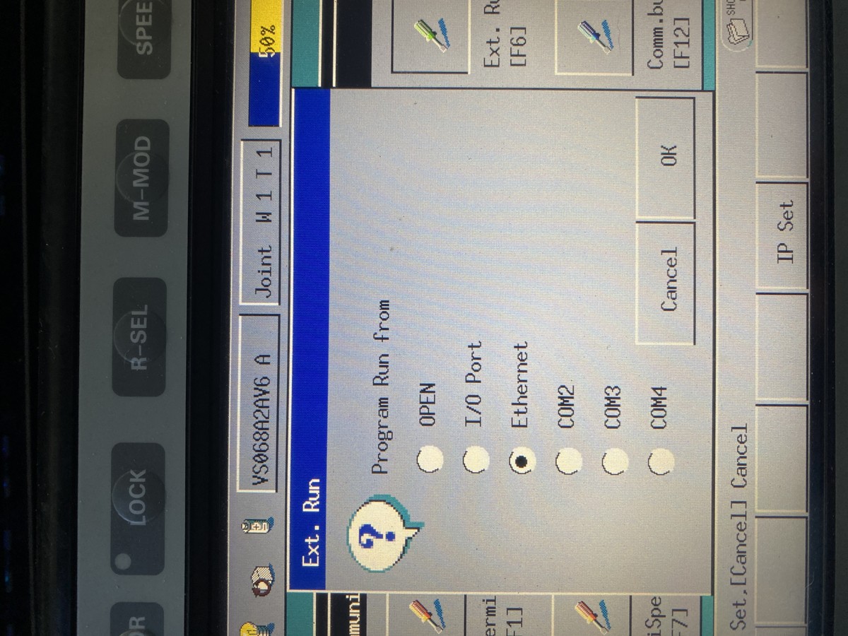

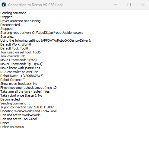

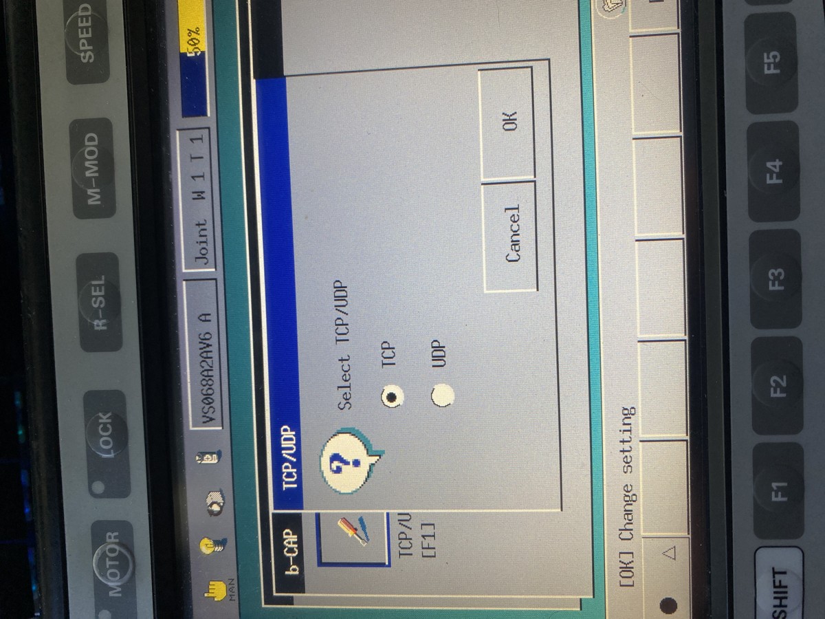

I have followed a few of the forum posts about connecting to the Denso RC7 controller.

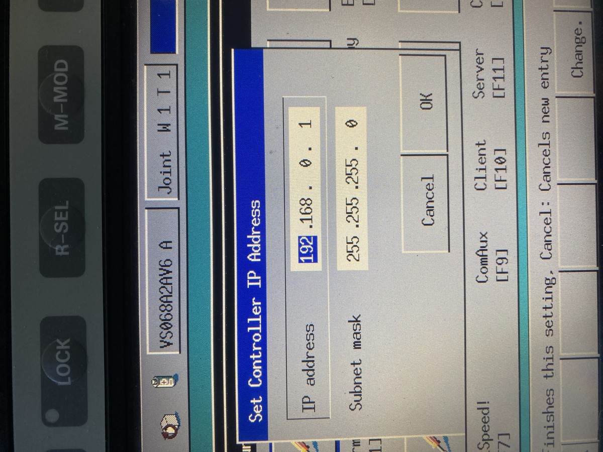

1. I successfully connect to the Denso Robot using IP address 192.168.0.1 in Denso WincapsIII.
2. I have edited Apidenso to false for rc8 or later.

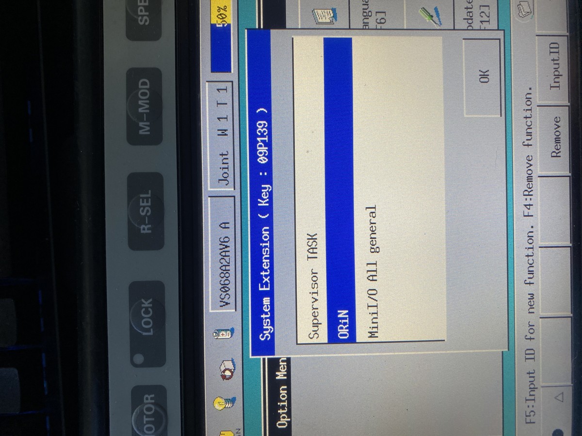

3. I have gone through the videos posted by another enabling the Bcap server and enabling ORiN

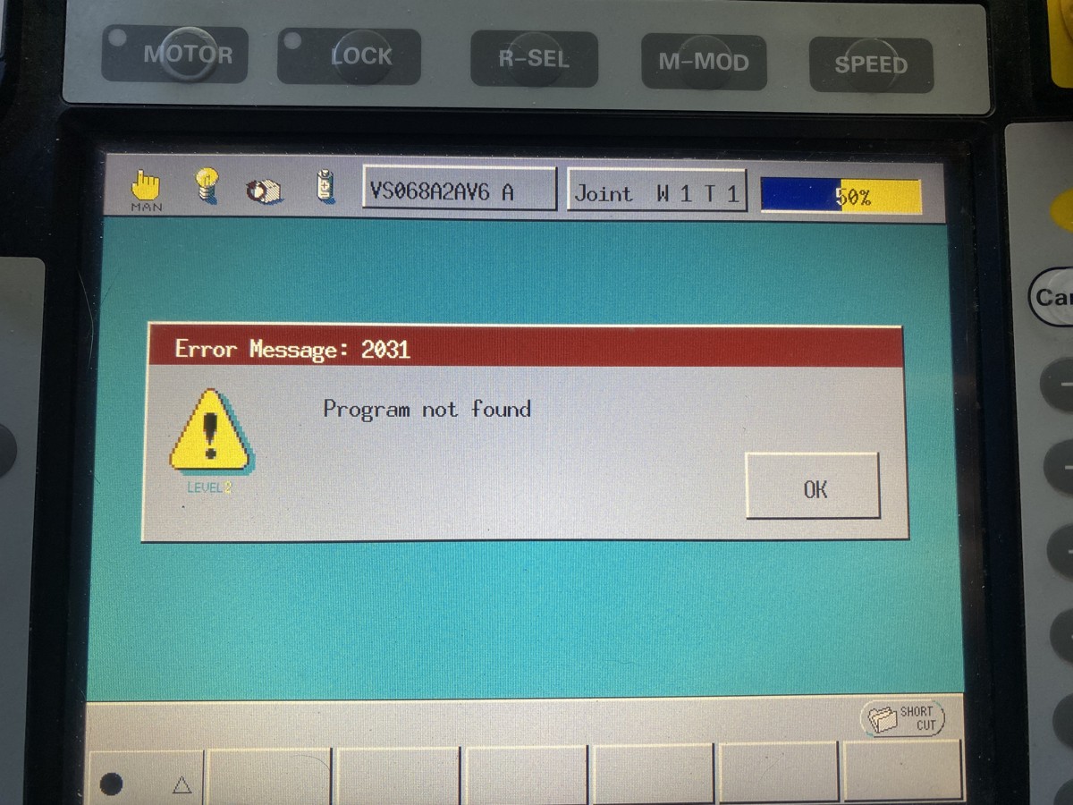

I have not been able to connect to the robot successfully. When I try and hit connect, I sometimes get a 2031 error message saying that the program is not found. I was hoping that with the images provided, I could get some assistance on what is left to try and figure out on this robot.
