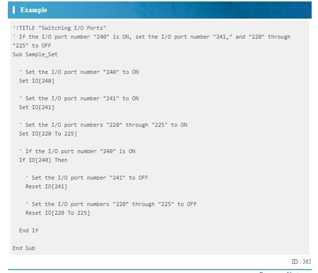

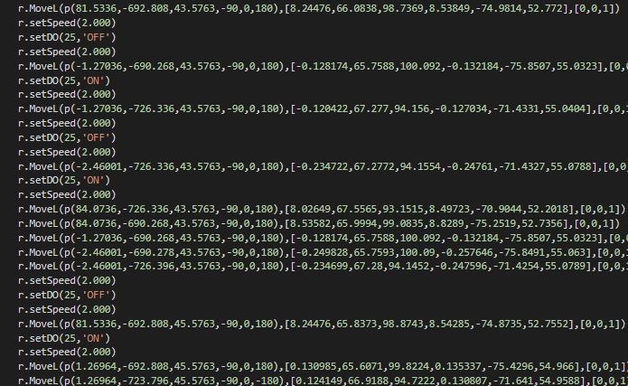

I am looking to turn on and off an Output IO on my Denso controller to start and stop an extruder controller for 3d printing.  I have the basic logic down but I cannot seem to have RoboDK send the correct command that the Denso Controller wants to see.
I have attached:
How RoboDk post the IO
How Denso Manual declares IO as Set and Reset.
A test .RDK file
I am looking to turn on IO 25.
Additionally, I would also like to set the acceleration to 100%  from RoboDK.  When I adjust these settings in RoboDK it does not post a command with my speed (2.000). Is there something I'm missing?
