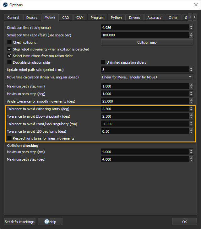

Go to "Tools"->"Options"->"Motion"
Those are the tolerance you can play with.
RoboDK's default parameters are relatively conservative.
