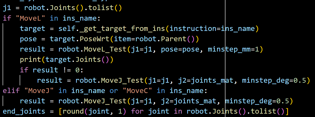

I'm struggling to properly use MoveL_Test. I know the linear move is feasible in the simulation and on-line. (I've successfully run the move many times on-line), but MoveL_Test returns -2. Would you please help me understand how I'm calling this method incorrectly?
# Get current robot joints:
j1 = robot.Joints().tolist()
# Get target pose w.r.t the robot base:
pose = target.PoseWrt(item=robot.Parent())
result = robot.MoveL_Test(j1=j1, pose=pose, minstep_mm=1)
You should provide the pose of the active tool with respect to the active reference (not the robot base) to the MoveL_Test function.
Assuming the target is already attached to the right coordinate system you don't need to use the PoseWrt function. So you should be able to do something like this:
j1 = list(robot.Joints())
# Get the target pose:
pose = target.Pose()
