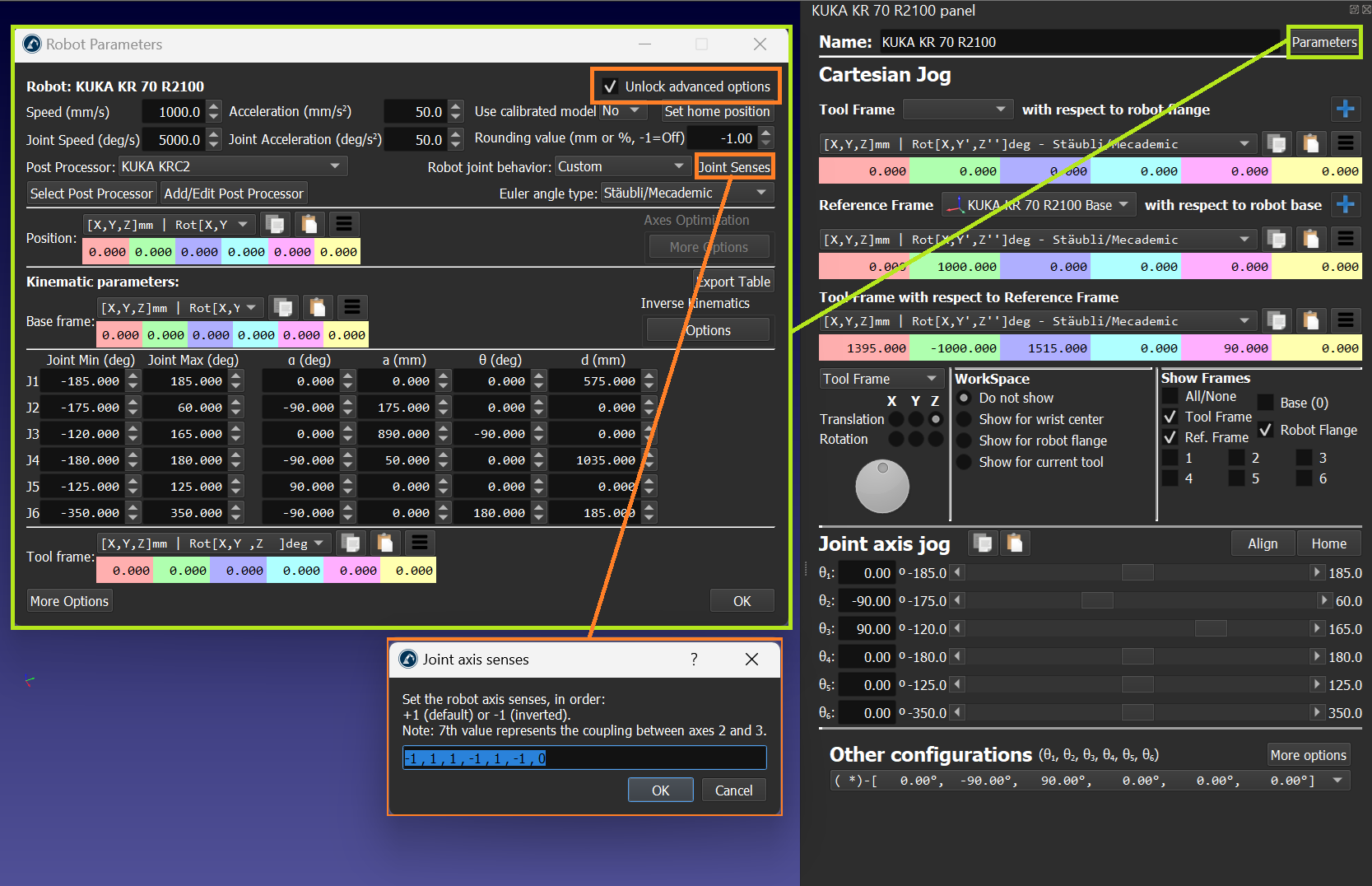

To change the direction of axis movement, it is necessary to change the corresponding values in the Robot Parameters - Unlock advanced options - Joint Senses :
I attached the corrected robot.
Please let us know if you still have issues with it.

(06-17-2024, 03:03 PM)Sergei Wrote: To change the direction of axis movement, it is necessary to change the corresponding values in the Robot Parameters - Unlock advanced options - Joint Senses :
Thank you, Sergei!
It works well now after following your instructions.
Have a great day!
