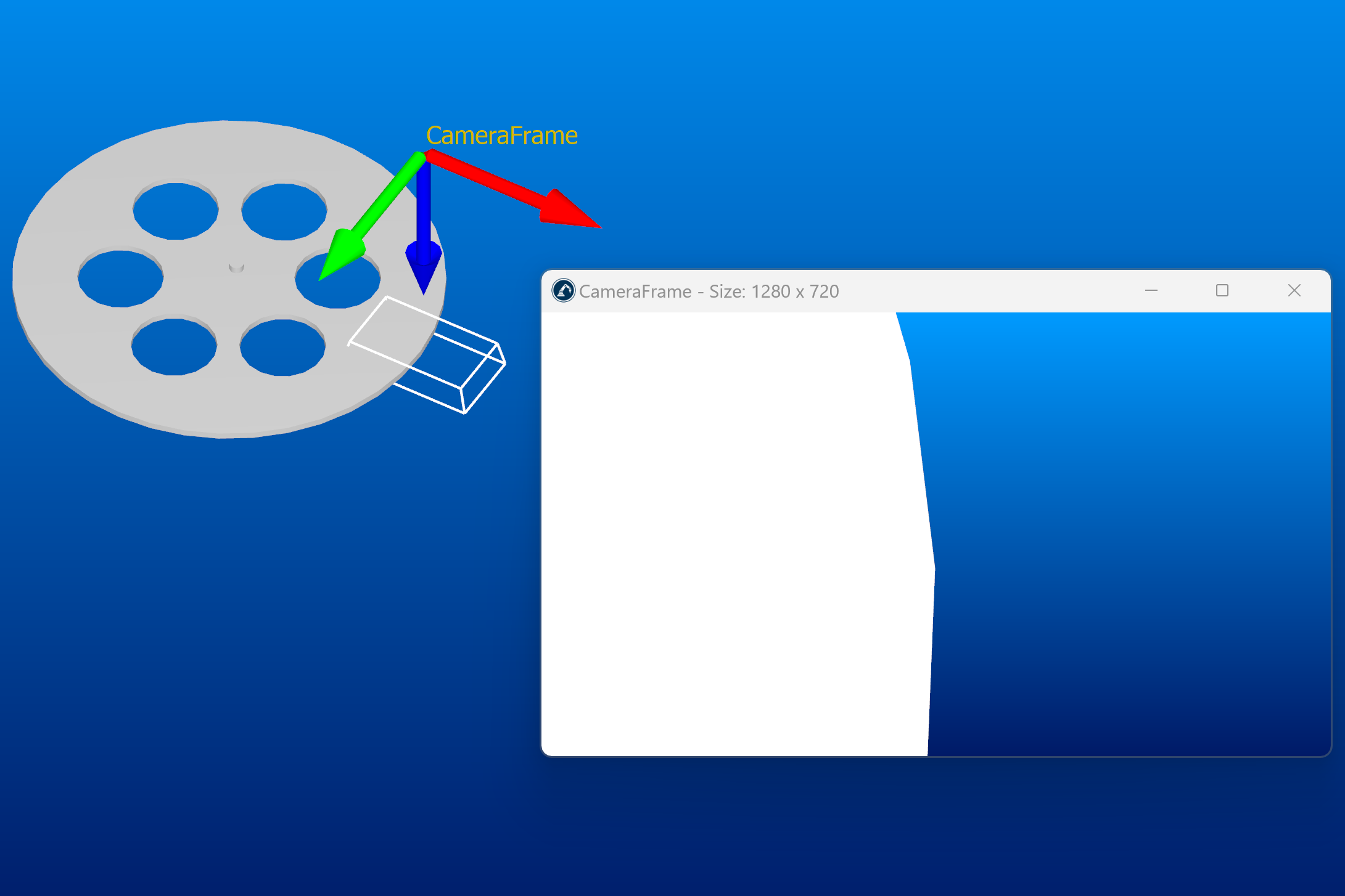

Display & camera render quality
I'm taking snapshots using a camera, but the render quality of the objects is equal to the overall display and set very low. E.g. a round disc shows as a polygon. How can I set RoboDK's overall display render quality, and is it possible to set a higher render quality for a specific camera/snapshot?
Kind regards,
Maarten
The quality of the display depends on the quality of the 3D model or the mesh. If you imported this part as a STEP or IGES file, you can improve the tolerances when importing parametric files like STEP and IGES format:
  1. Select Tools-Options
  2. Select the CAD tab
  3. Set the Linear accuracy of the surface (mm) to 0.1 mm
  4. Set the Angular accuracy of the surface (deg) to 0.1 deg
  5. Reload the part and you should see an improvement in quality
