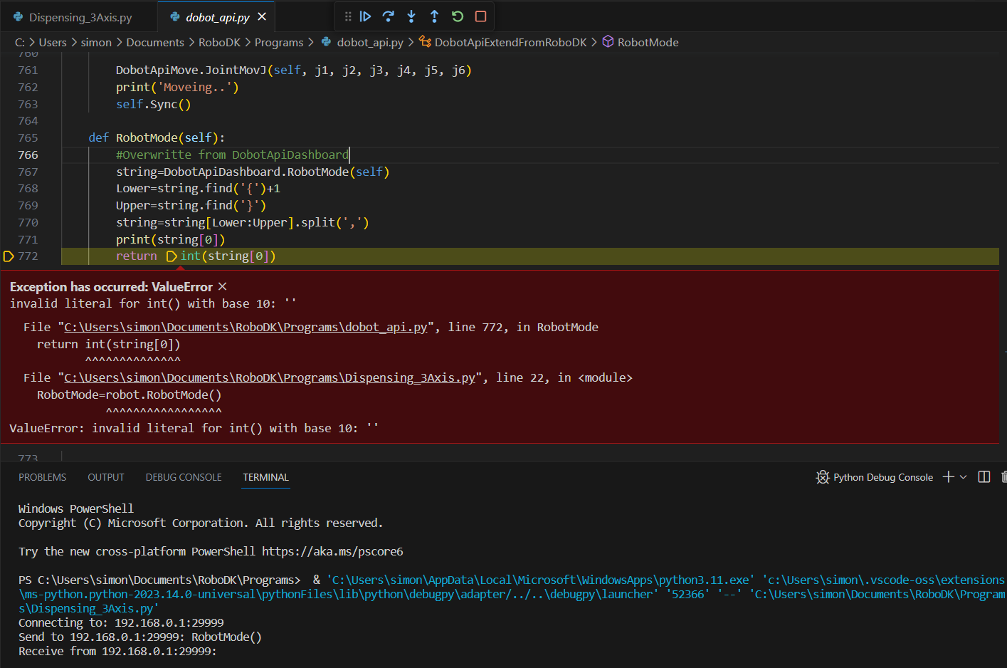

Have a Dobot CR5 that I'm trying to run off of RoboDK. I have the robot set in TCP mode, roboDK is able to ping and connect to the robot but that's about it. I have the RoboDK CR5 dispensing demo loaded and when I try to generate the program I get this error in debug. Could anyone assist in what could be going wrong? Thank you.
