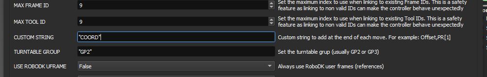

As a supplement for each line of movement I have COORD and I found a way for that.
The problem is that the addition of COORD is not allowed on the J movement
How can I make an exception to not put the COORD addition on the J movements?
Somewhere in the postprocessor for sure, but I don't know where?
Can you hellp?

I'm sorry for the delays. I just got back to your email with an updated version of our Fanuc post processors. You should now be able to output COORD only on linear movements. Since you have a Professional license we can continue our conversations by email and our technical team can better help you with your post processor customizations.
