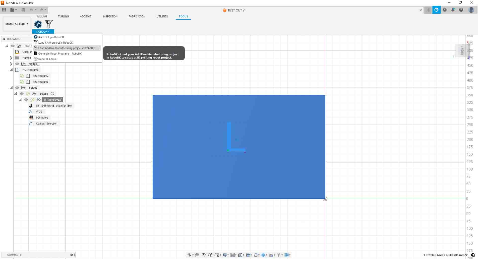

I am trying to import a test engraving toolpath (I know it does not have the proper tool installed) and I cannot for the life of me to get it out of RoboDk.
I have the model on the table, but I cannot get the cam program to show up in the center of the part.
Please the attached files.
I have tried all the RoboDk menu options in Fusion 360, but not of the seem to work. I have clicked on faces etc. The only thing that I can get to come in correctly are points.
I have followed the instructions tot he best of my understanding, but I still cannot get it to work.
Ideas?

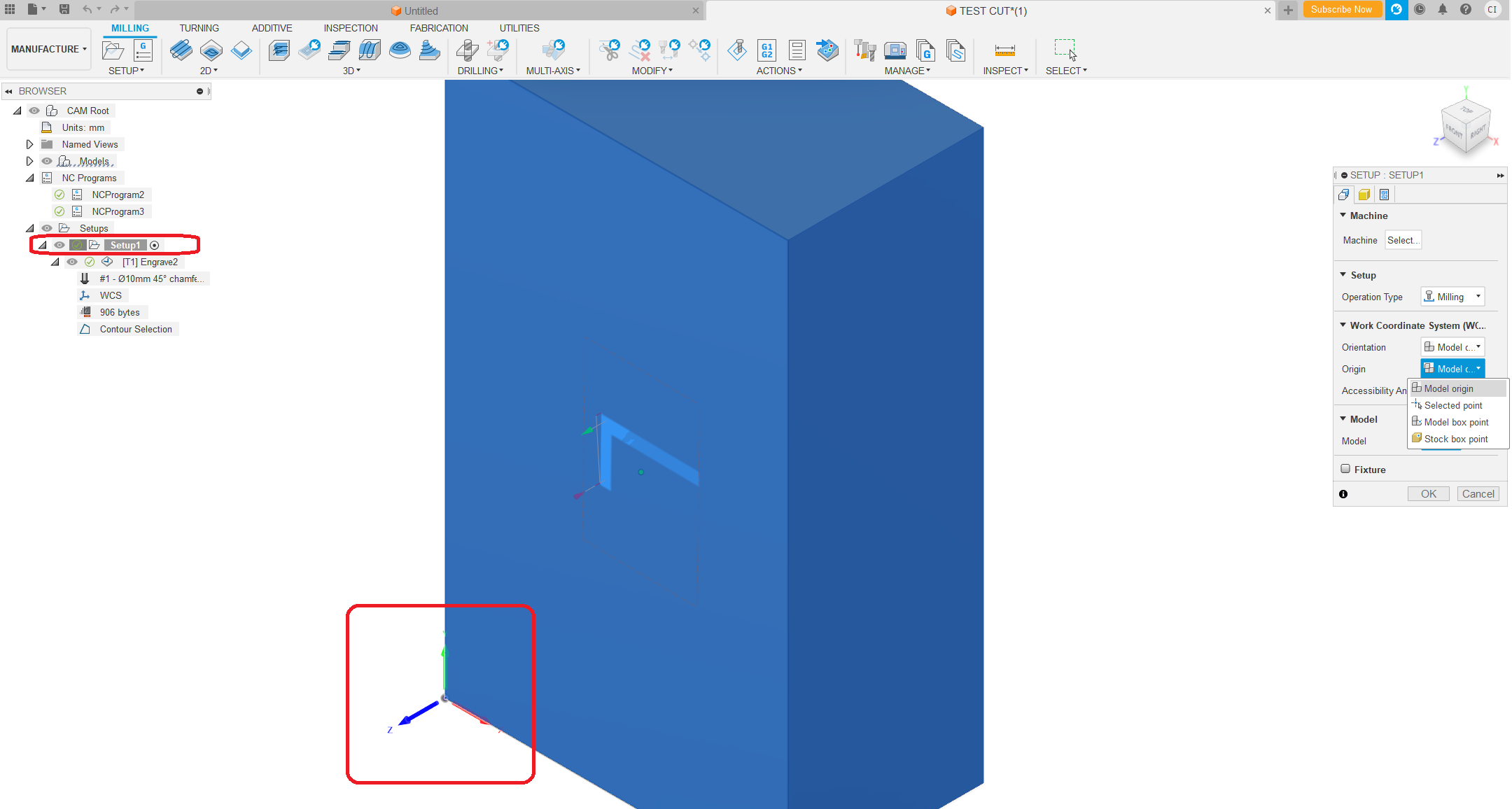

You should specify the stock origin in Autodesk Fusion 360. You can do so by following these steps:
  1. Double click your setup (Setup 1)
  2. Select the Origin dropdown
  3. You can choose the option Model origin
See attached image.
Thanks Albert!
This worked.
