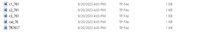

I have a relatively minor issue with how RoboDK is generating TP files. My Rj3ib controller allows a max of 8 alphanumeric characters for program names. My post-processor in RoboDK specifies a max of 10 (changed to 12 in image due to experiementation). However, regardless of what I change the max characters to, it will always output 6 and cut off any other characters. My images provide an example.
In RoboDK, the program names are all <= 8 characters but will get trimmed off when generated as shown in the file explorer screenshot.
