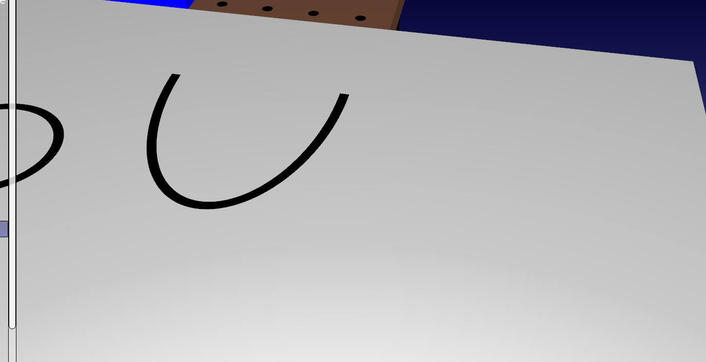

Is there any way I can perform an elipse moviment? I know we have moveJ, moveL, and moveC. But i need to inspect this image:
To build an elipse, we need at least three targets...

It is not possible to use splines or ellipses. Robot controllers don't usually support this type of movements.
Therefore, a robot machining project or a curve follow project will help you follow curves which have been split into smaller segments.
