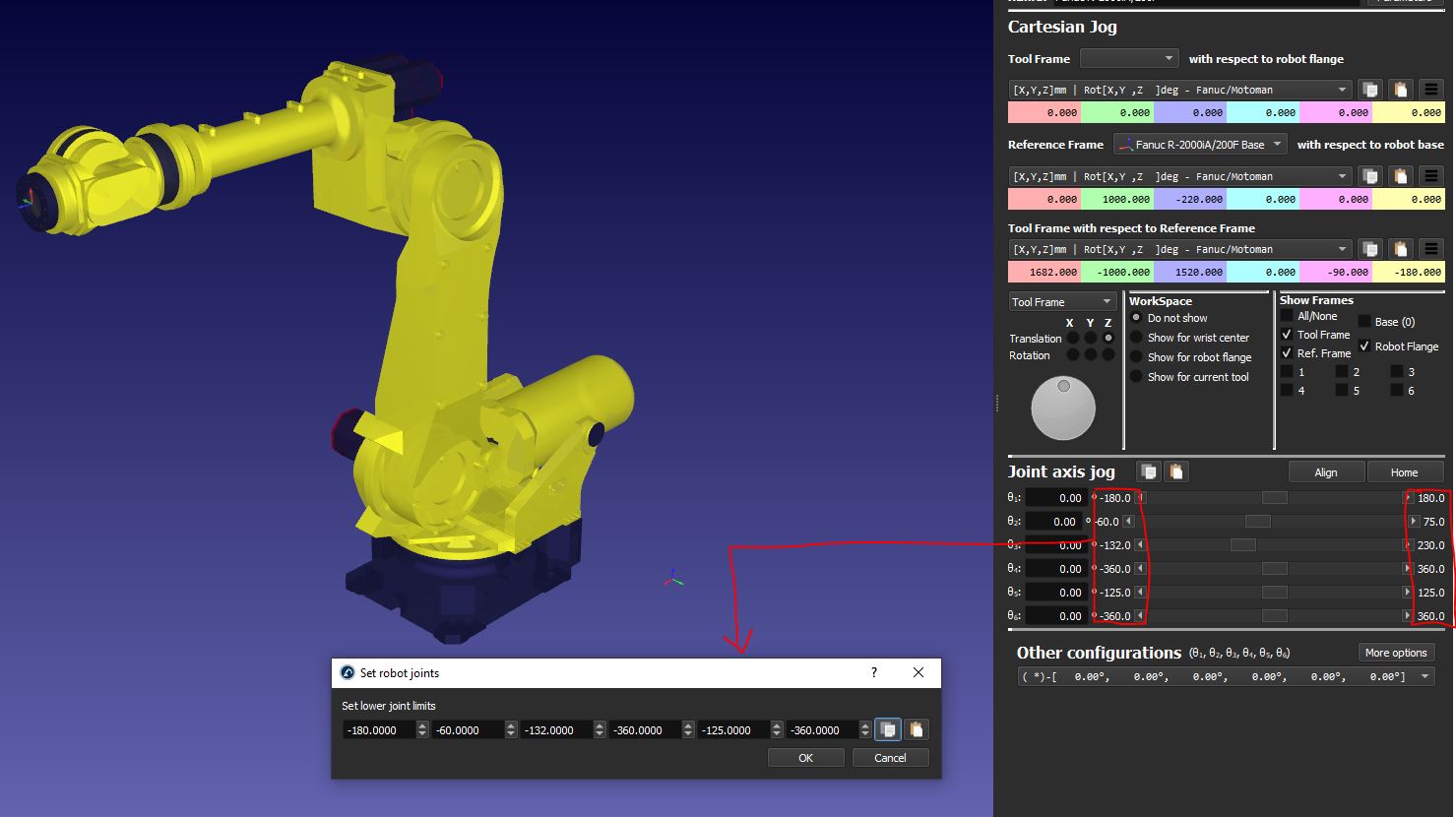

I make programm in RoboDK- everything is ok,but when I export to Roboguide I have an Limit Error
How can I get all limitation in RoboDk for check my limits inside RoboDK ?

Thanks for your answer! Its a joint axis limits

You can double click the robot to open the robot control panel and see all joints limits.
You can also customize these limits by clicking on the limits numbers and change them to values that work better with ROBOGUIDE.
Before doing that, make sure you are using values that work with your robot according to its specifications.
