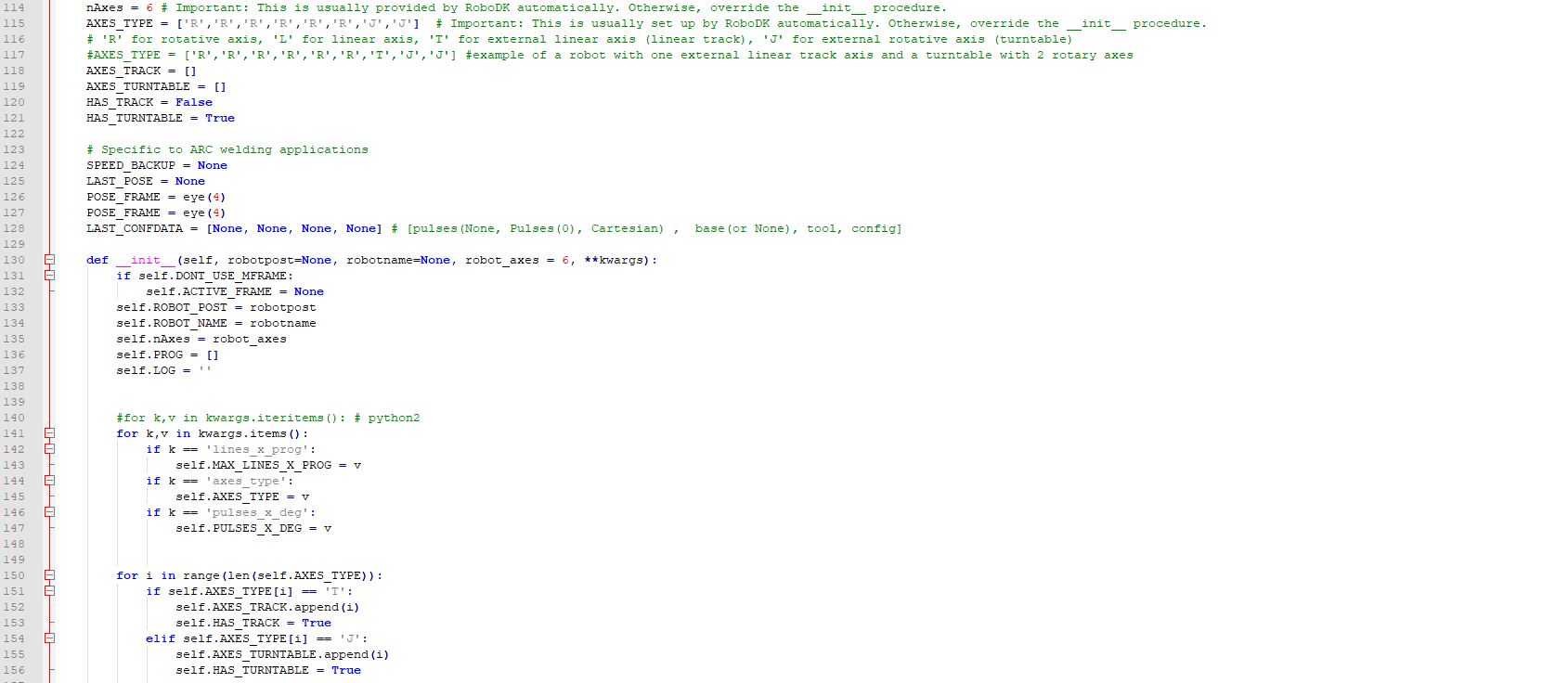

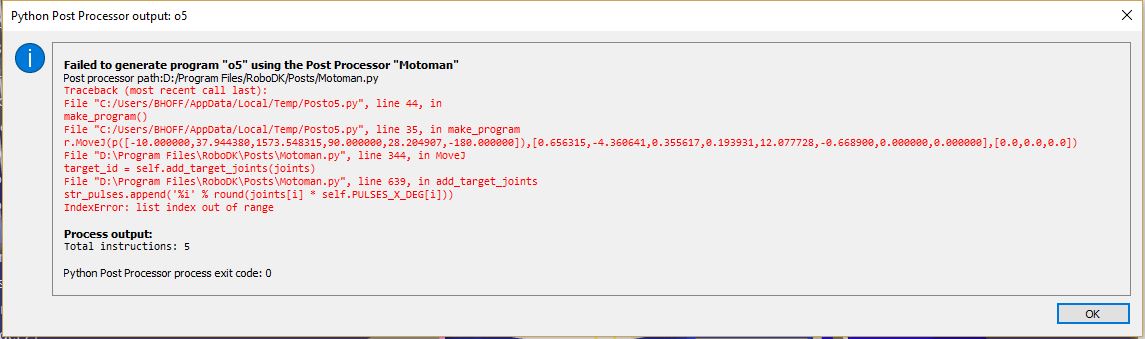

The problem is, if I want to add the external-axes and generate a .JBI-file, the python post processor script runs into an error, even tough I added them in the script.
What am I making wrong?

I recommend you to take the post processor attached. It will properly support external axes. Also, make sure to manually enter the pulses/degree for the external axes in the post processor (variable named PULSES_X_DEGREE).
