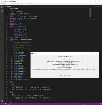

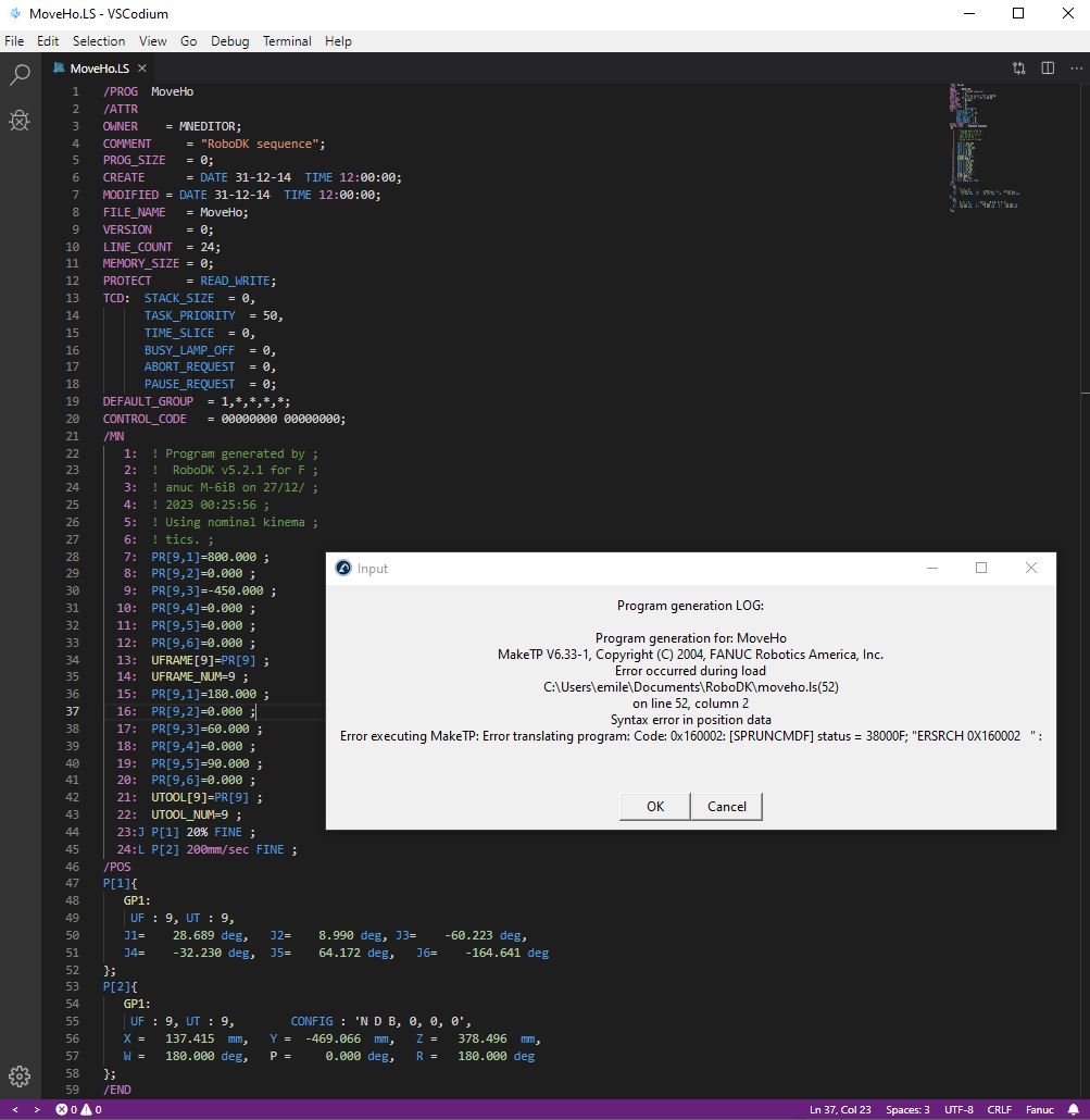

Hi Albert,
Thanks for your reply.
I'm generating the program but not sending it to the controller directly.
I assumed that using the RJ3 post processor would be the correct one but I also tried the RJ30 which gives the same result (error).
Posts: 35
Threads: 10
Joined: Jan 2022
Reputation:
0
I also have a project with a R2000i robot. For this robot the generation of TP files works fine.
Before I switch over to the M-6i project I generate a new robot.ini file using setrobot.exe (not sure if this is required). This doesn't help either.
Any suggestions?
