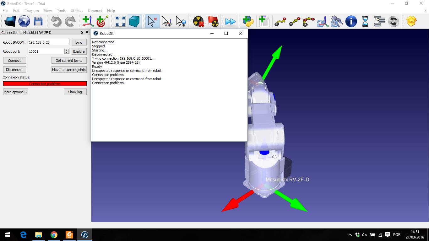

I have a Mitsubishi Arm RV-2F-D Series. Looking on the libraries I saw that this library is not allowed yet. I'm trying to use the RV-4FL library and changing the parameters. Is that possible? I'm getting an error when I try to connect robot and roboDK.

I'm also having the same problem. My robot is RV-2FR Q series connect through CR800 Q series driver, I have try to connect my robot using TCP/IP and successfully ping it. But everytime I press the connect button, it keeps saying "Stopped" at the connection status. Please help me to connect robodk to my real robot please.
What is the model of your robot controller?
Could you provide us with a print screen of the connection log?
