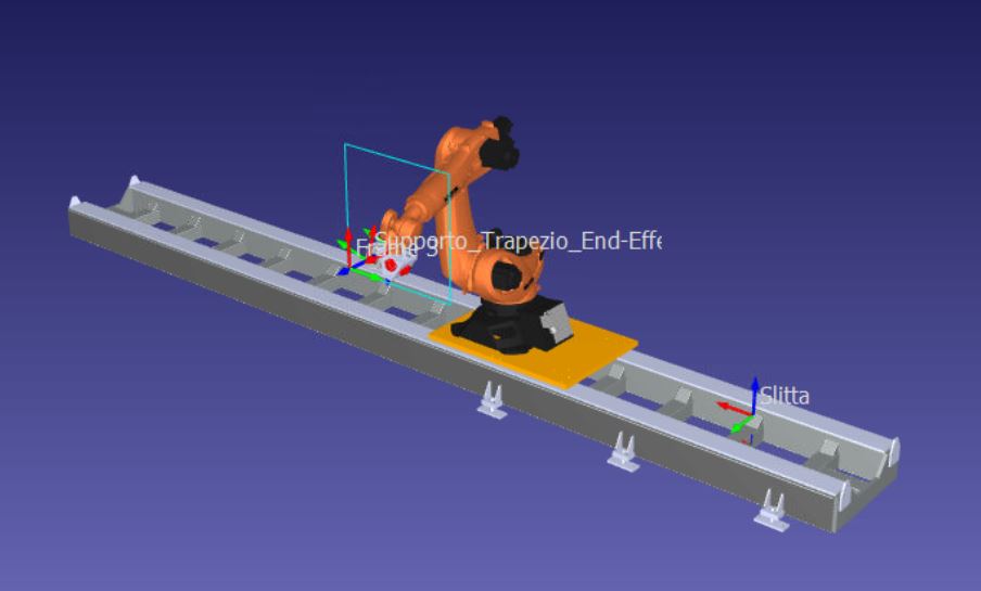

i have a Kuka 7 axis on the slide ( 9 mt ) . I have try to do a simple work mill .
