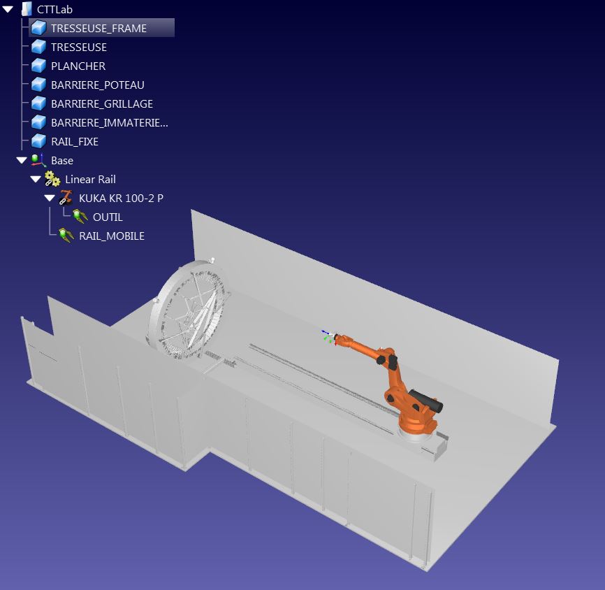

I experience issue while programming a path with robodk. My station looks like instation png. My code looks like this :

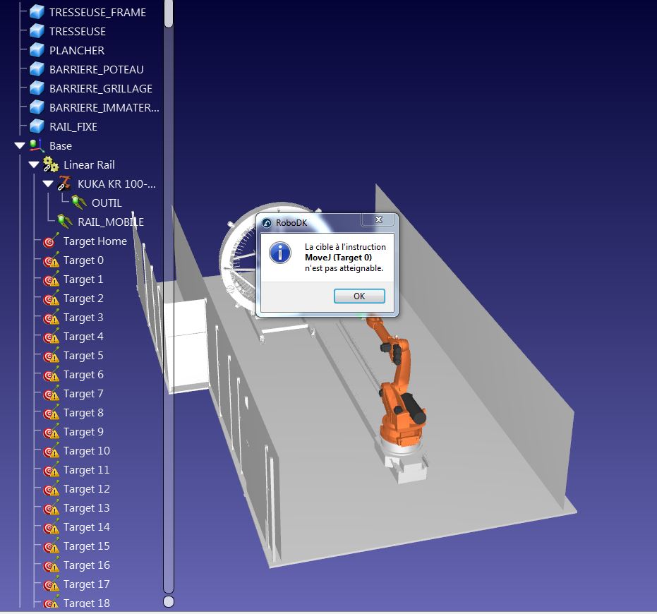

When running the corrected program, i get an error that the target is out of reach. as shown in the picture enclosed.
Do you have an idea of where it can come from ?

Unfortunately, it doesn't solve the "target out of reach" issue. What about it ?
I should precise that I acheive placing the targets. It just says that they are out of reach while obviously they are not.
Can you share the RoboDK project (RDK file)?
You may need to set a value for the external axis so targets can be reached.

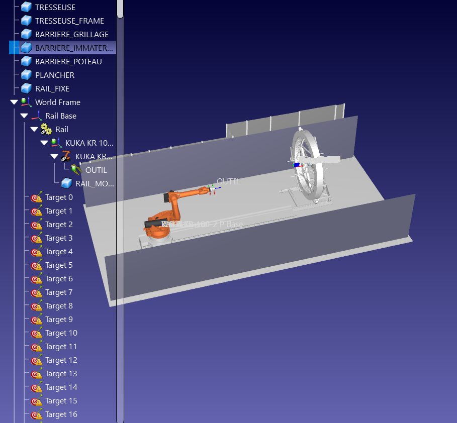

Indeed I did kind of solve the issue using the previous code however. I have a lot of point and it takes very long to generate using this mean. I use the MacOS version of RoboDK and the straight forward method to create target using the API works. However when back to the windows version, it still doesn't work.
The straight forward code I use is this one :
        RDK = Robolink()
        robot = RDK.Item('KUKA KR 100 HA', ITEM_TYPE_ROBOT)
        if not robot.Valid():
            raise Exception('No robot selected or available')
        world_base = RDK.Item('World Base', ITEM_TYPE_FRAME)
        camera_base = RDK.Item('Camera base', ITEM_TYPE_FRAME)
        tool = RDK.Item('Tool 1', ITEM_TYPE_TOOL)
        RDK.Render(False)
        # Specify the reference frame you want to use
        program = RDK.AddProgram("{} Picture Analysis".format(name_prog), robot)
        program.setPoseFrame(camera_base)
        program.setPoseTool(tool)
        program.setSpeed(speed, 200, 10000, 800)
        target_name = 'Approach target'
        pose = Mat(htm[0].tolist())
        target = RDK.AddTarget(target_name, camera_base, tool)
        target.setAsCartesianTarget()
        target.setPose(pose)
        program.MoveJ(target)
        for i in range(htm.shape[0] - 1):
            target_name = 'Target {}'.format(i)
            pose = Mat(htm[i + 1].tolist())
            program.MoveL(target)
It generates me the following file.
When launching the program it says that the target is not reachable.
Here is the file
.rdk   M301_01.rdk (Size: 1.86 MB / Downloads: 1,027)
