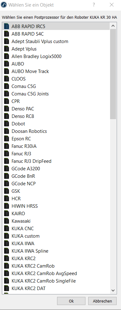

Just one more question back to exporting the points: where can I find the CSV post-processor? I tried to change the post-processor from the default "KUKA KRC2" into "KUKA CamRob CSV" and then export the program, but the exported file is blank, and "KUKA CamRob CSV" is the only CSV post-processor I can find in the post-processor list (as shown below).

Hi Jeremy,
I've searched through the list and still couldn't find the CSV post processor, I've attached the post processor list below:
Is it because of the robot I am using? Or the version or RoboDK I am using? I am currently using RoboDK v4.0.1.13451 release date: 2019-11-01.
Robo
Oh, yeah, that's an older version that did not include that specific post-processor.
