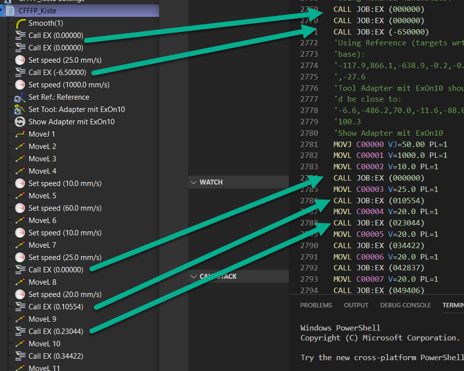

Hi Jeremy,
in Yaskawa, it is not possible to use numbers with decimals as an Argument, Only Integers are allowed. But In ROBODK I become the speed of extruder as integer and decimal value for example :
Call Extruder (1510.560)
Is it Possible to get the number only in Integer form like:
Call Extruder(1510)
Please see the attached Photo?
BR
#12
Hi Otto,
Here's a new post-processor that should remove the decimal.
You can then divide by 100 000 once you retrieve the value in the controller.
Hope it helps.

Hi Jeremy,
I added the new post-processor to my program but unfortunately, it didn't solve my problem. I still have the decimal!
Otto
#14
(01-20-2021, 05:30 PM)Jeremy Wrote: Hi Otto,
Hope it helps.
Hi Jeremy,
the problem is partially solved.
At first, it didn't work, because I found in the Python File that the dot is missed (.)
 # Remove special characters
   for c in r'-[]/\;,><&*:%=+@!#^()|?^ ':
       progname = progname.replace(c,'')
After Adding the dot the problem is solved.
But I got now the program in such form:
CALL JOB:EX61356
MOVL C00341 V=60.0 PL=1
CALL JOB:EX61576
MOVL C00342 V=60.0 PL=1
CALL JOB:EX61576
MOVL C00343 V=60.0 PL=1
and in Yaskawa, it is not acceptable to call a program without space after program name (EX), and also the argument has to be between Brackets like below:
CALL JOB:EX  (61356)
I tried to give the brackets and space in the Program Events but no gain...
can you please guide me to solve this issue?
THANX!
Otto
#15
Hi Otto,
Could you join your .rdk station so that I can test the modification before sending it to you.
#16
(01-26-2021, 05:34 PM)Jeremy Wrote: Hi Otto,
Hi Jeremy,
Please find the attached file.
Thank you:-)
.rdk   Motoman_SPS_LOGO.rdk (Size: 6.61 MB / Downloads: 1,142)
#17
Hi Otto,
I think that this one should work.
Hope it helps.
.py   Motoman_Extruder_Decimal.py (Size: 42.39 KB / Downloads: 1,054)
