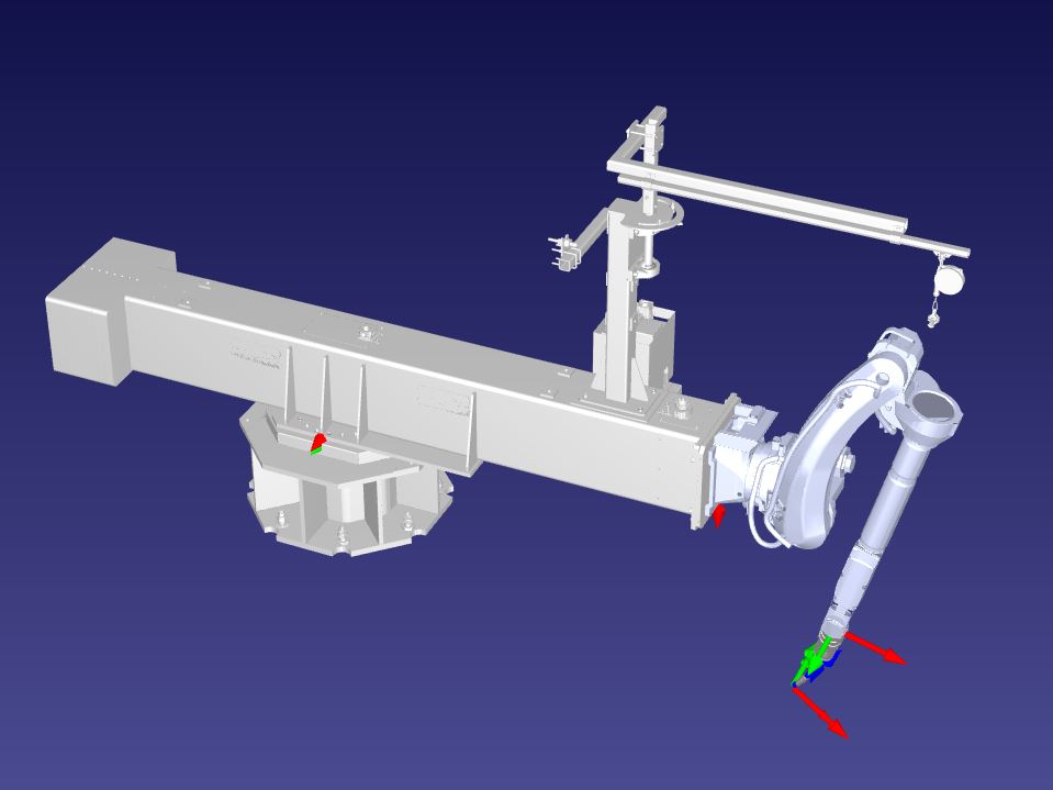

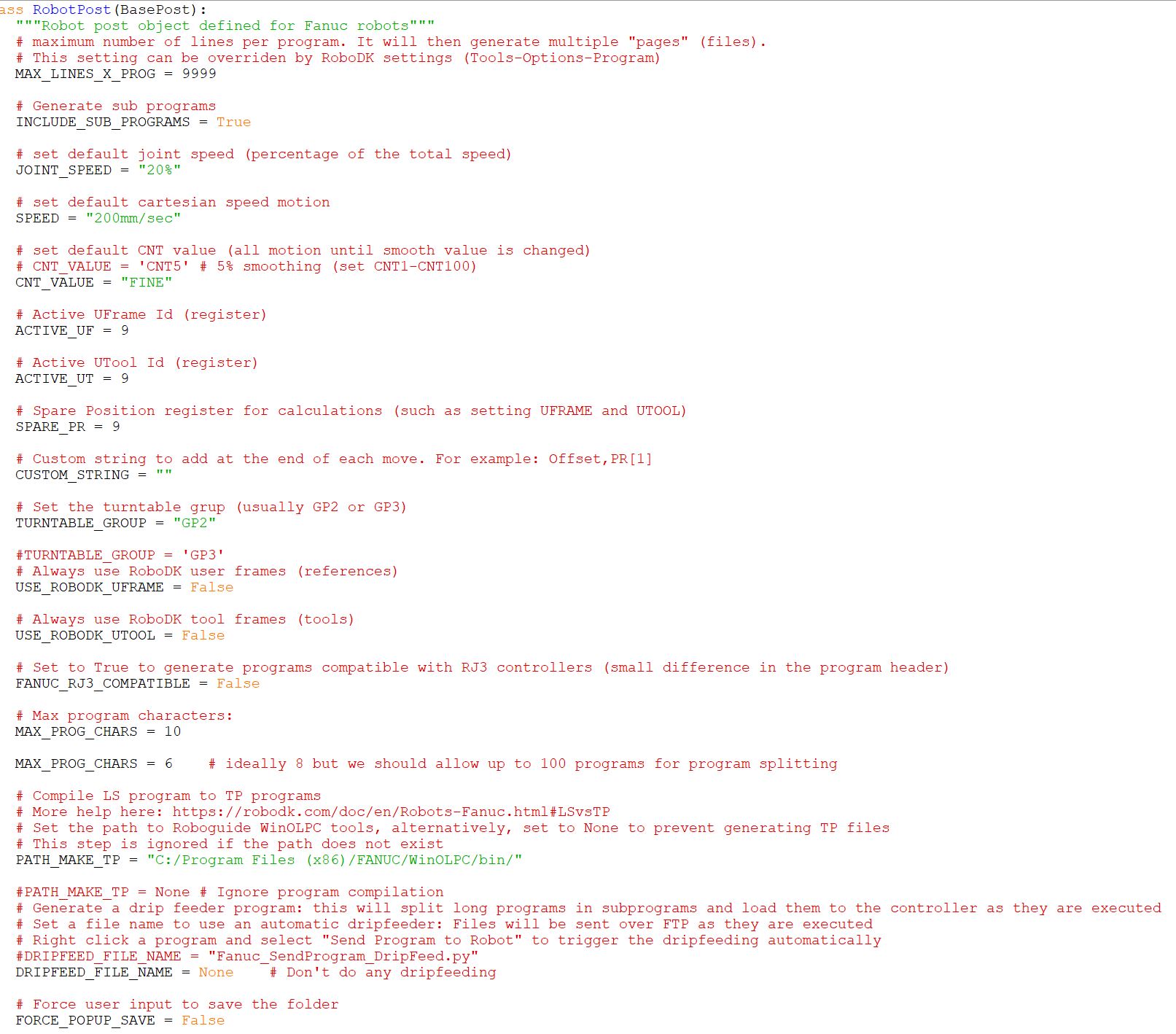

My cell:
FANUC ArcMate 120iD/12L + integrated rotary axis (7th axis)
R30iB+ controller
When I generate the program with the R30iA post-processor, the X,Y,Z,W,P,R,E1 coordinates are not correct, the E1 coordinates are in mm instead of degrees.
Do you have a solution ?
I don't know which instruction I have to add in the post-pro to write the coordinates correctly...
Below are some pictures to help
Thanks in advance,
