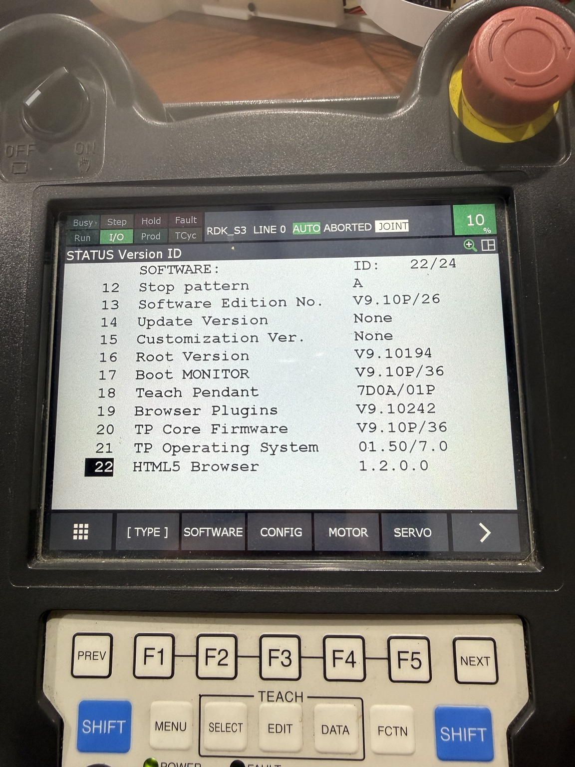

  • Controller software V9.10P/26
I replaced the controller programs using the V9 RDK_S3.PC and accompanying TP files from the downloaded driver package, but the issue persists.

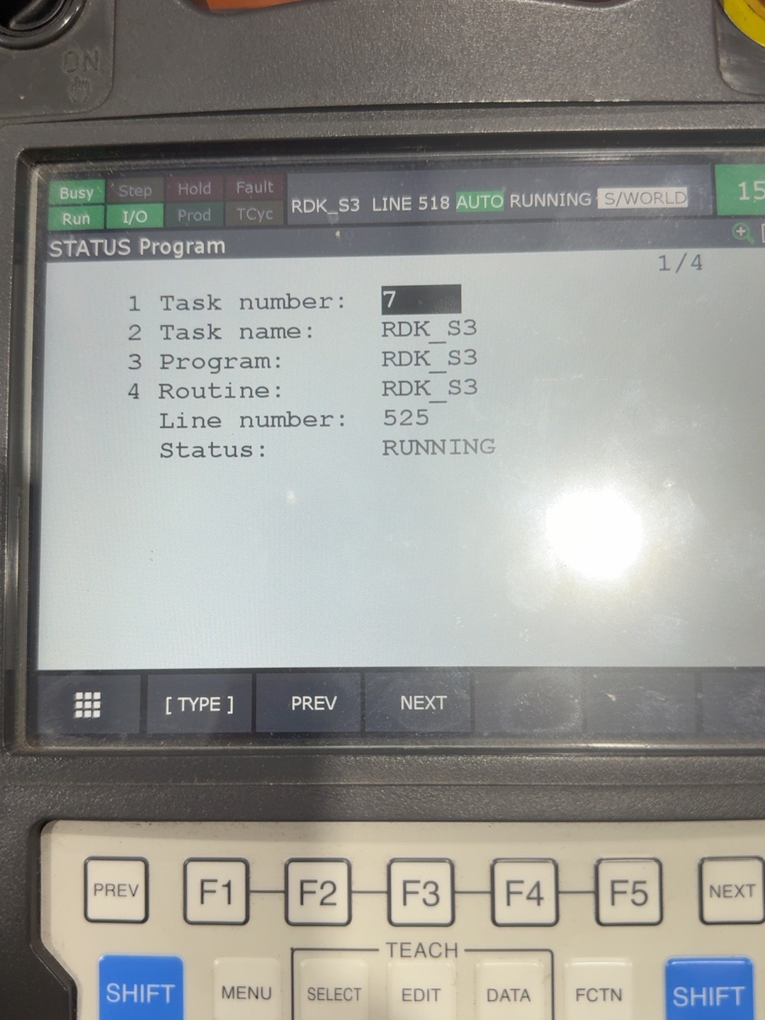

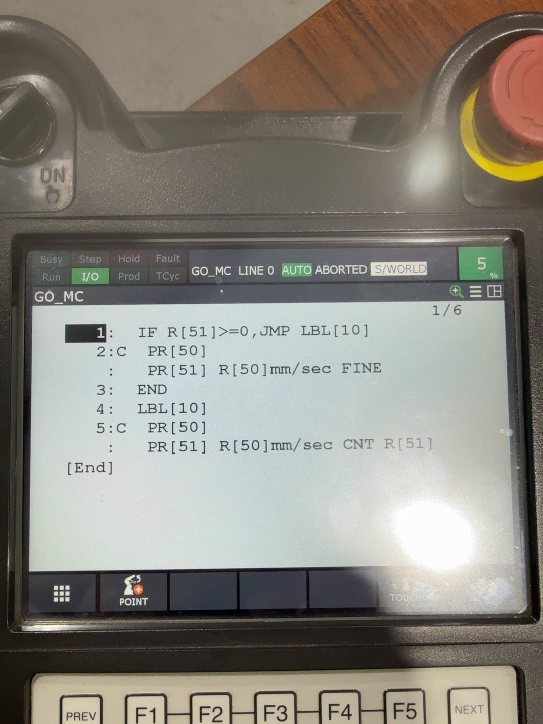

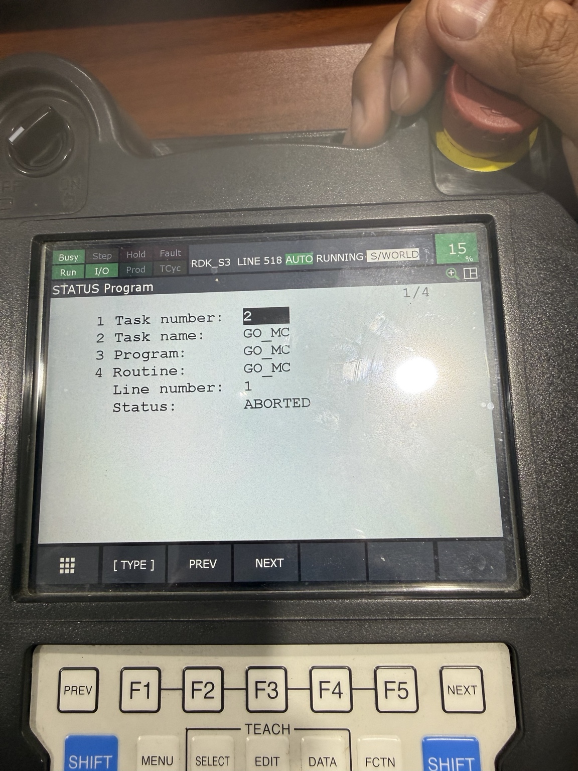

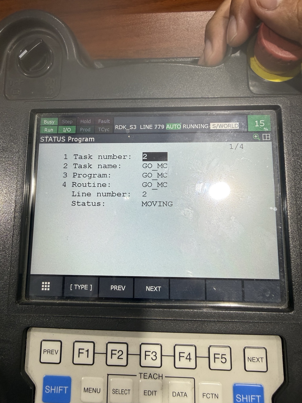

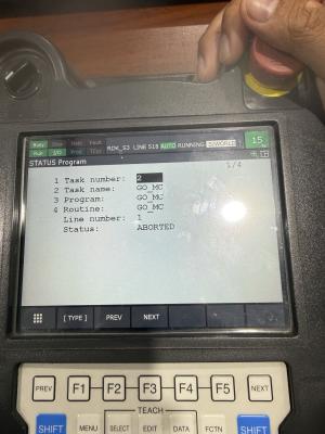

During the arc, GO_MC shows MOVING at line 2. Afterward, it shows ABORTED at line 1, while RDK_S3 remains RUNNING with observed line readings around 516–525. There are no active alarms or corresponding alarm-history entries.

IMG_2D4556DB-C5B0-4495-B036-678E34FBA1B4.jpeg    IMG_564E910A-76F6-44C4-B4AD-E90926DBECA8.jpeg    IMG_0995.jpeg    IMG_0997.jpeg    IMG_0998.jpeg
