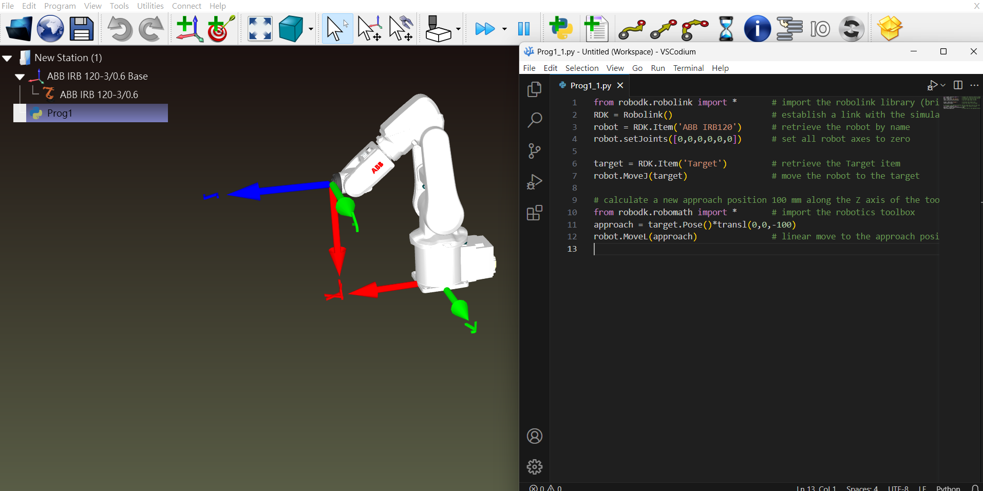

  I think that I missunderstood the way to manipulate the robot in RoboDK. I just copied sample codes and paste on Python then executed it without open up RoboDK
I've learned that the right way is open up RoboDK and select ABB Robot manually, and add Python program in RoboDK then execute it

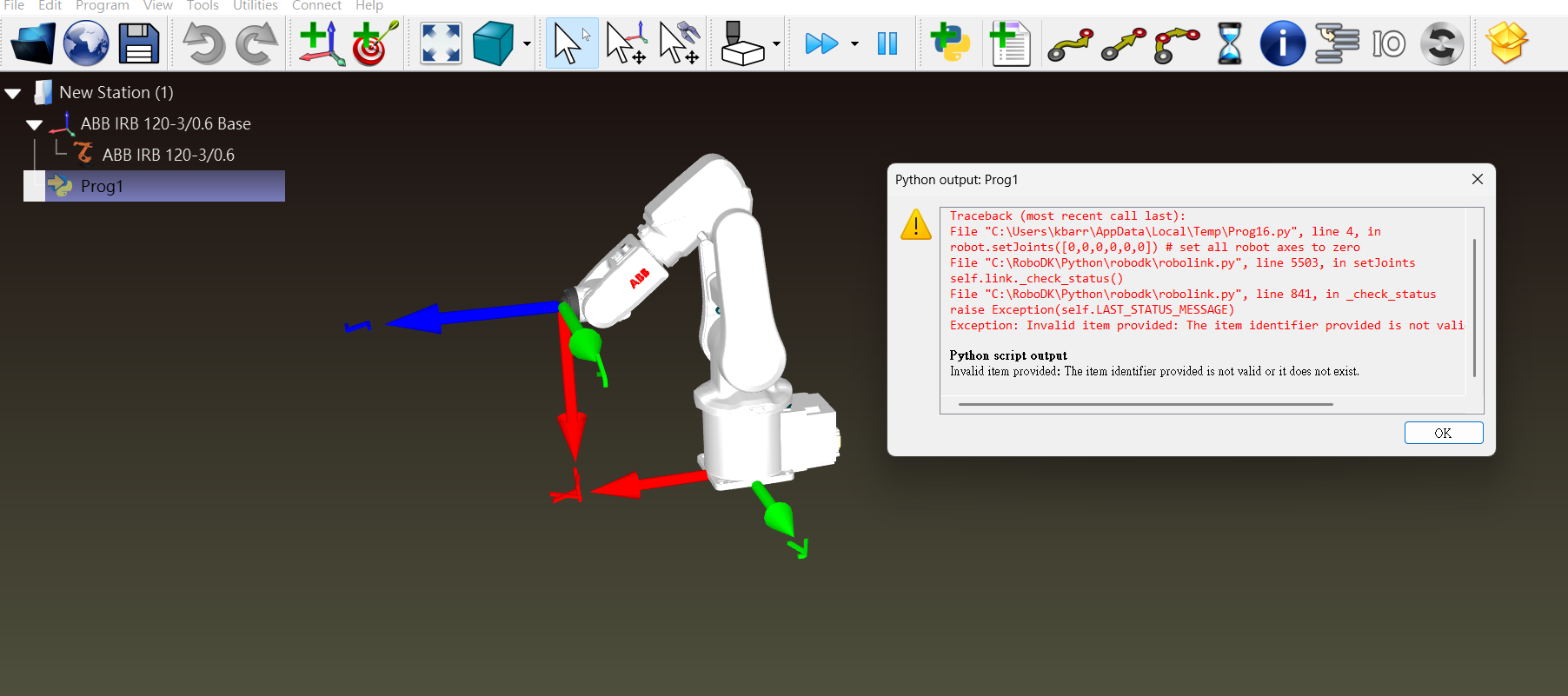

Somehow I've encountered errors as attached

You should properly use the full name of your robot in the RDK.Item command.
You can also use the ItemUserPick to popup a message to allow the user to choose the right robot:
robot = RDK.ItemUserPick('Choose a robot', ITEM_TYPE_ROBOT)
You can also not specify the name and specify the robot item to take the first available robot:
robot = RDK.Item('', ITEM_TYPE_ROBOT)
