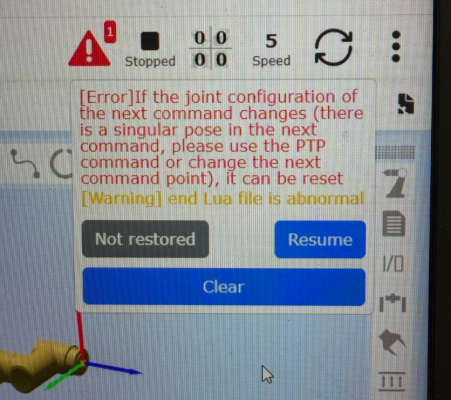

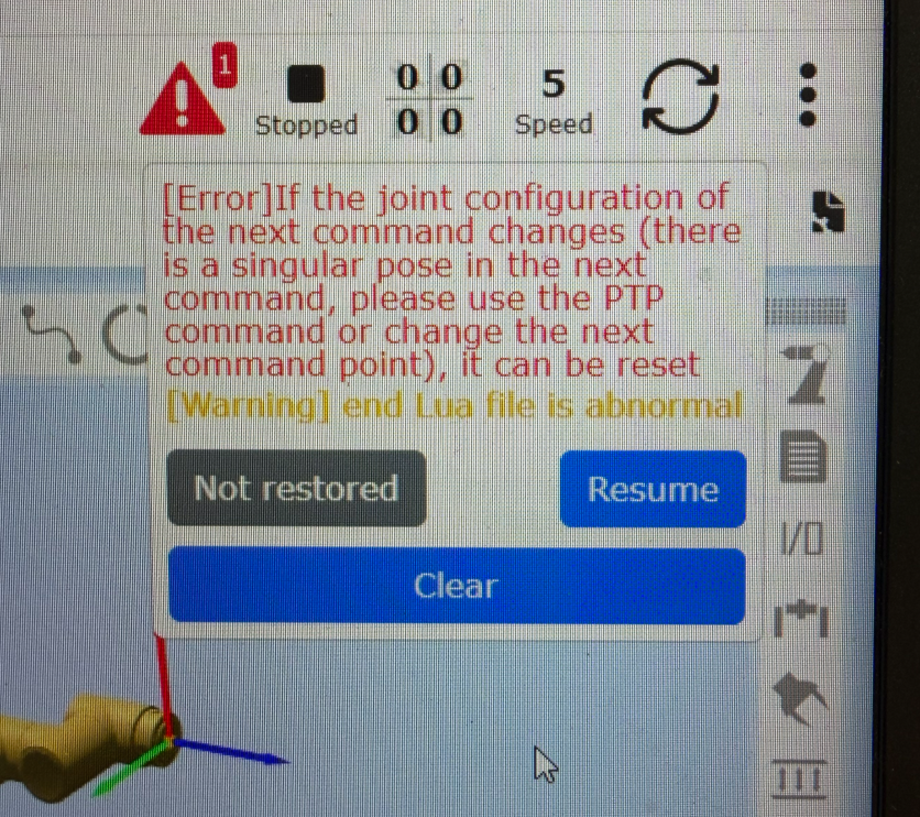

In attempting to troubleshoot the attached program error on a Fairino cobot controller I noticed that the existing Fairino post uses a different command syntax than the most recent (V3.9.7, updated 6/25/2026) Lua script manual as found here:  https://fairino-doc-en.readthedocs.io/la...intro.html
Specifically, SetToolCoord and SetWObjCoord are not referenced in the new manual, and while these commands are referenced by prior versions of the Lua manual, the function structure does not appear to match either.
Would you mind verifying if the Fairino (not Fairino db) post processor needs updating, and if this might be the source of my error?  Thanks very much.
Could you share a few example programs that actually work on your setup and this program generated by RoboDK that pops the error; along with your RoboDK station file. Let me verify and update the post as required.

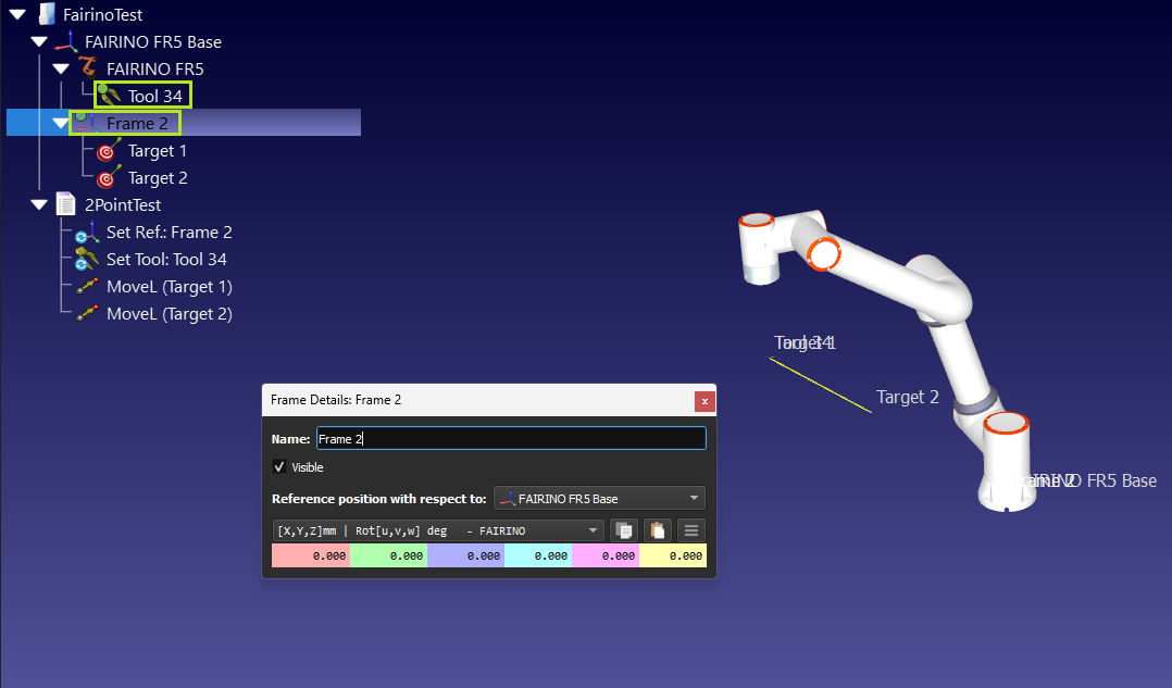

The tool and coordinate system numbers simply need to be specified explicitly
If the robot's coordinate system is used, the identifier of the coordinate system will be 0
-- program: P2PointTest()
-- Program generated by RoboDK v6.0.7 for FAIRINO FR5 on 15/09/2026 16:08:35
-- Using nominal kinematics.
-- Setting reference frame:
-- Frame 2: 0.000,0.000,0.000,0.000,0.000,0.000
SetWObjCoord(2,0.000,0.000,0.000,0.000,0.000,0.000,0)
WaitMs(500)
-- Tool 34: 0.000,0.000,200.000,0.000,0.000,0.000
SetToolCoord(34,0.000,0.000,200.000,0.000,0.000,0.000,0,0,0,0)
WaitMs(500)
tj1,tj2,tj3,tj4,tj5,tj6=GetInverseKin(0,497.000,-274.038,477.000,-180.000,0.000,-90.000,-1)
MoveL(tj1,tj2,tj3,tj4,tj5,tj6,497.000,-274.038,477.000,-180.000,0.000,-90.000,34,2,30,100,10,-1,0.000,0.000,0.000,0.000,0,0,0,0,0,0,0,0)
tj1,tj2,tj3,tj4,tj5,tj6=GetInverseKin(0,497.000,94.806,477.000,-180.000,0.000,-90.000,-1)
MoveL(tj1,tj2,tj3,tj4,tj5,tj6,497.000,94.806,477.000,-180.000,0.000,-90.000,34,2,30,100,10,-1,0.000,0.000,0.000,0.000,0,0,0,0,0,0,0,0)
-- program end

I didn’t include the specific problem in the file I uploaded. I have another station where I added a separate coordinate system. To keep track of the coordinate systems, I renamed them according to their respective tasks. After I renamed them, the postprocessor understandably didn’t update the tool number in the Fairino program, the renamed coordinate system was set as reference for the programm.
For completeness I attach the original file, where the problem occured to me.
