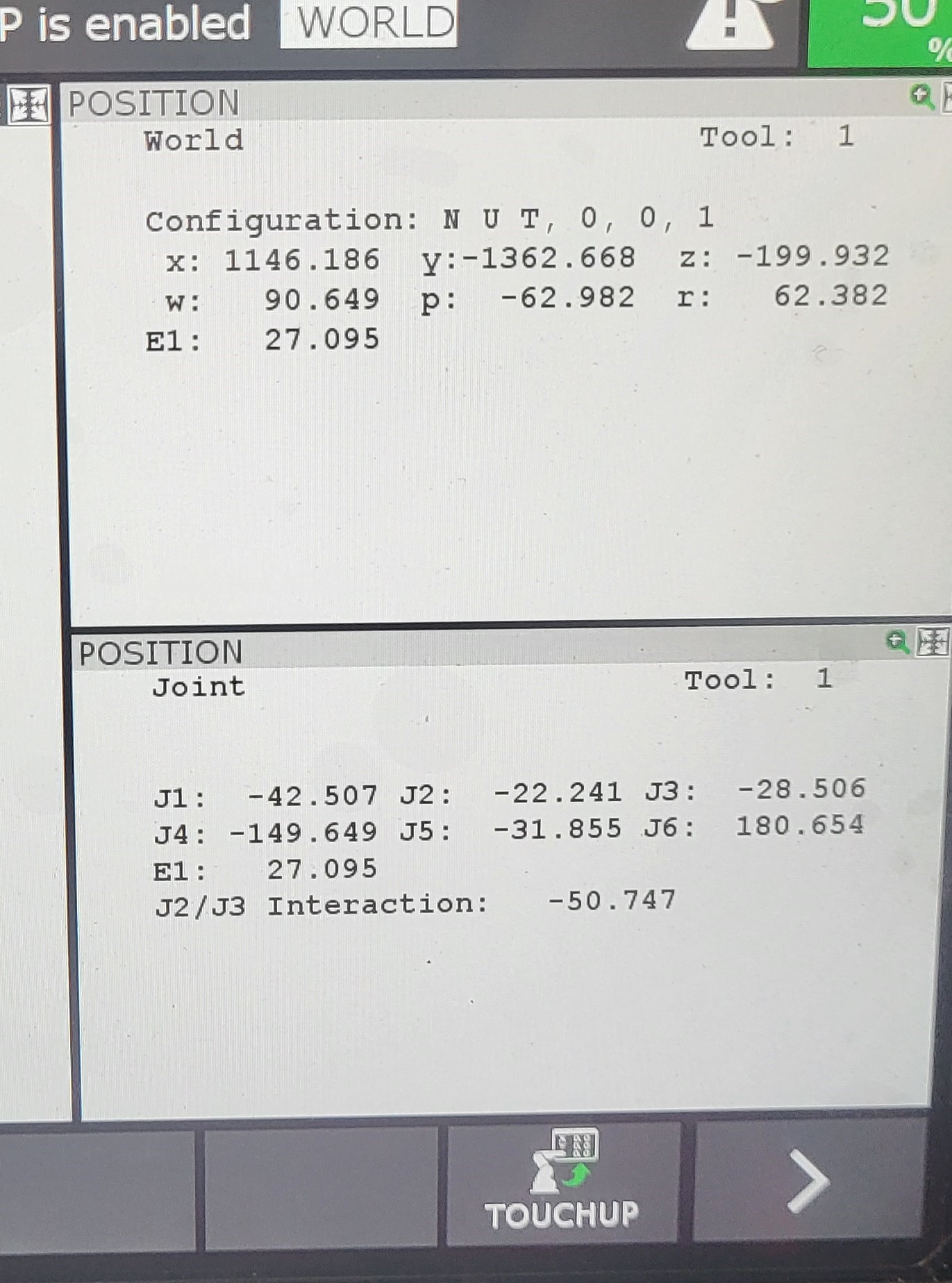

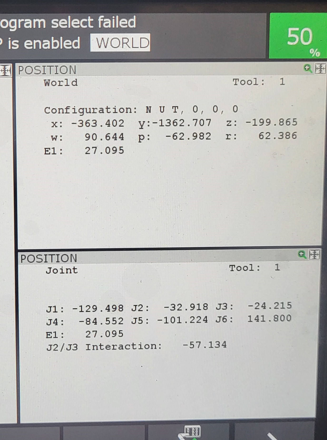

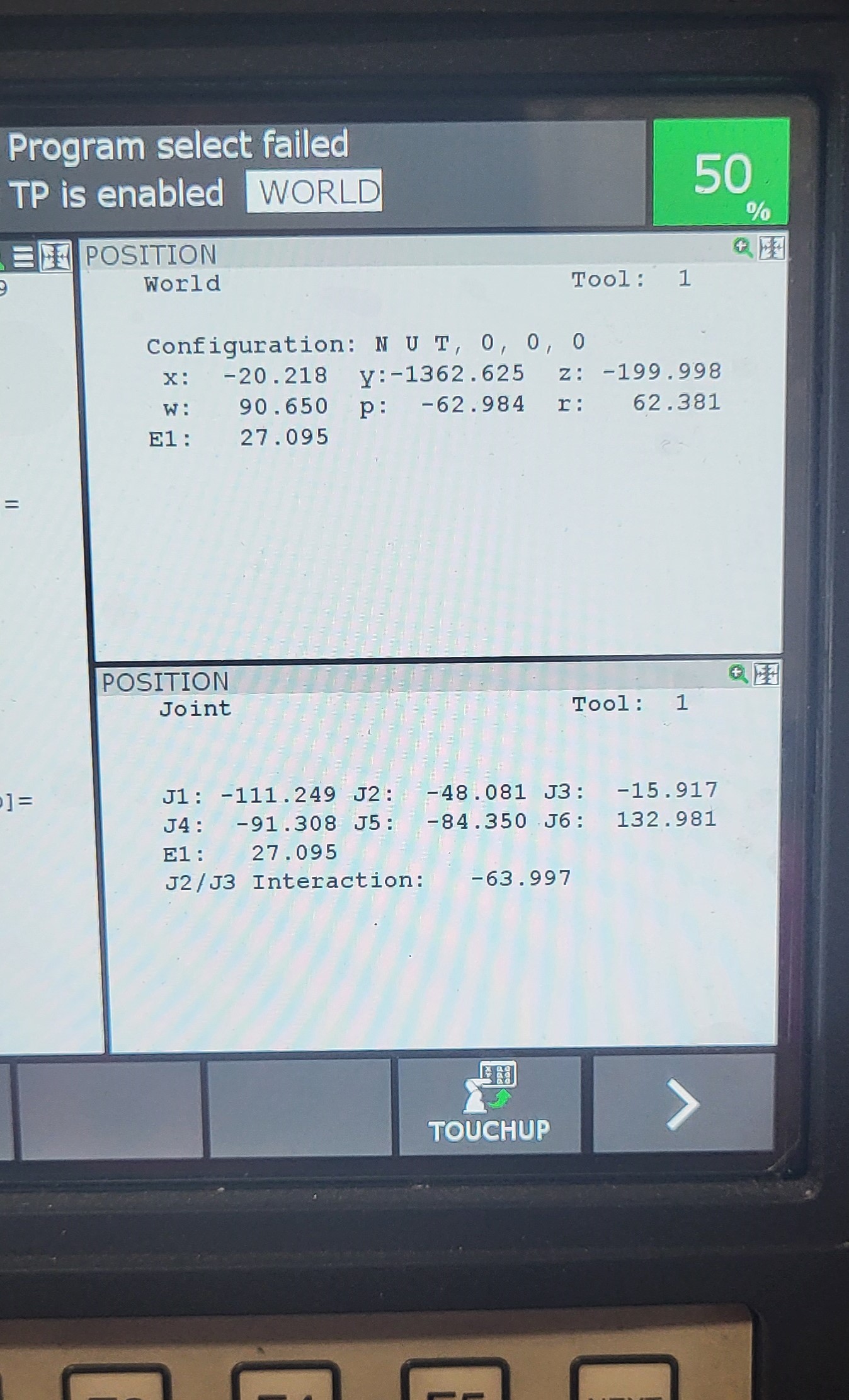

I am having issue with this M-900iB/360 model again. It does not match the reality of the robot. Our cell configuration require robot to be operated at extreme reach position for J2 and J3 in linear motion. I can move robot in world base Y direction on the floor but simulation I cannot move through these positions. Please see the attached images. I was able to move it by going to parameters, options in robot kinematics then use iterative inverse kinematics. I am just not sure how accurate this resemble to reality.

Thank you for pointing this out!
Please try the updated robot and let us know if it works for you:
.robot   Fanuc-M-900iB-360_upd2.robot (Size: 299.29 KB / Downloads: 103)
