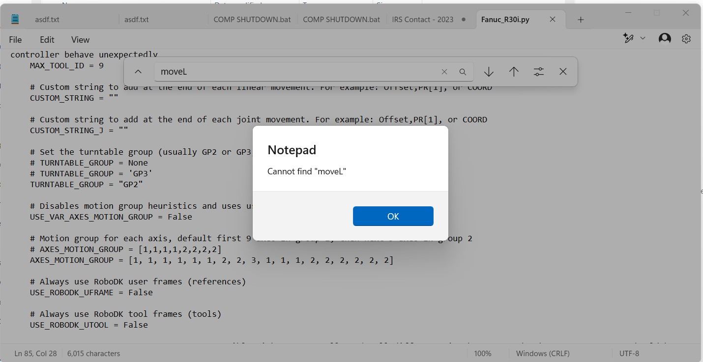

I followed the instructions in the link you sent, but they seem to be outdated, because after clicking "Ok" on the post processor (Program -> add/edit post processor), there are no pop-up windows with the settings that come up, unlike what is shown in the guide.
I have to use the text editor, and as I stated in the previous posts, there are no specific lines of code that relate to point generation from the targets (Fanuc R30i post). I've scrolled through the post processor over 20 times, and have had 2 other people look at it, and none of us can find the specific lines of code to edit.

What post processor or python script for RoboDK did you pull that code snippets from?
Nowhere in the Fanuc R30i found in "RoboDK -> Posts" is there a line of code that reads anything similar to what you posted above. That is the error I have been trying to point out that I needed help with.
I know what change I could have made or tested, I just havent been able to find the post where I could edit the "def MoveL" instruction.
.py   Fanuc_R30i.py (Size: 6.02 KB / Downloads: 385)
The Fanuc post processor you shared is a compiled post processor. You should use the original source code of the post processor instead. It is better if you contact us by email so we can provide you with the source code of this Fanuc post processor.
