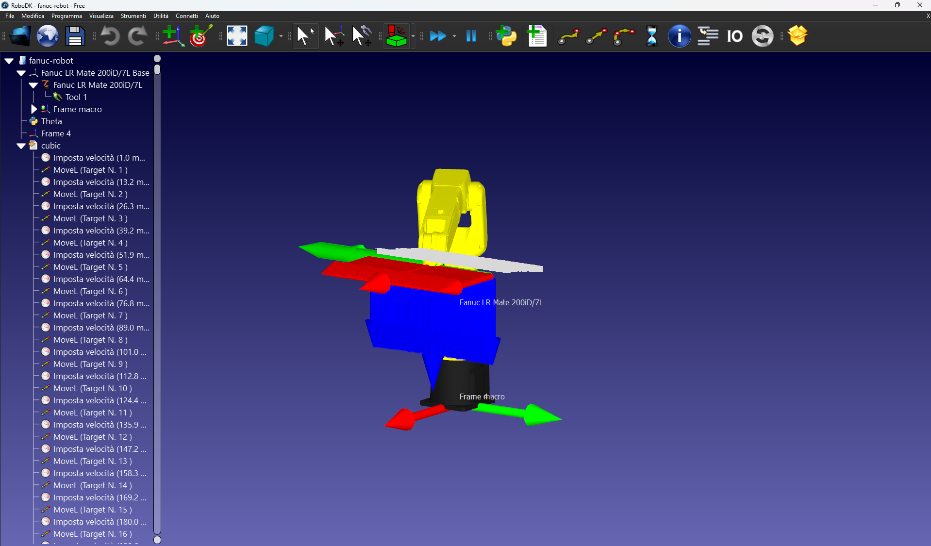

I have a problem with my Fanuc post processor. In particular i must export a linear trajectory generated by 1000 points. When I have consecutive same target the post processor deletes some points. In fact, the LS file contains 301 point and not 1000 as I planned.
How can i resolve the problem?
