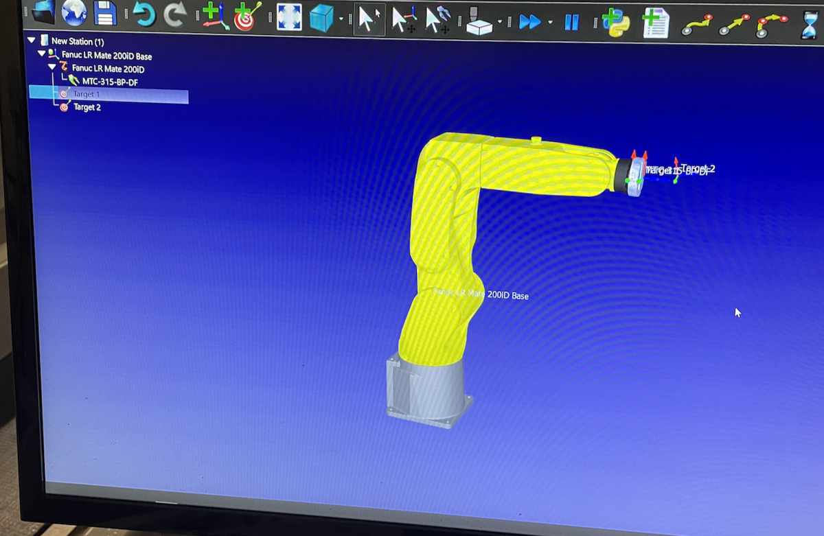

Here is my station. The program was simply a loop moving between both targets.

Here is a photo of the station with the program. It was just a simple loop between two points, and I tried both the RJ3 and R30i-A post processors to create the code.
It looks like the problem happens when you move to the home position (joints set to [0,0,0,0,0,0]).
Are you able to jog the robot to that location?
If not, do you see any error messages on the robot controller? You can access the full error log by typing the IP of your robot in a browser.
