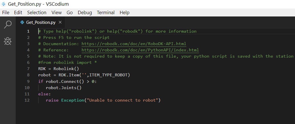

This is what my "Get_Position" macro in my RDK station looks like:
The only thing I did was to copy the script from the post by Albert and paste it into the Macro.
# Type help("robolink") or help("robodk") for more information
# Press F5 to run the script
# Documentation: https://robodk.com/doc/en/RoboDK-API.html
# Reference:     https://robodk.com/doc/en/PythonAPI/index.html
# Note: It is not required to keep a copy of this file, your python script is saved with the station
#from robolink import *
RDK = Robolink()
robot = RDK.Item('',ITEM_TYPE_ROBOT)
if robot.Connect() > 0:
  robot.Joints()
else:
  raise Exception("Unable to connect to robot")
Is that what you meant by "Did you "import" Robolink in your python program."?
I have attached my station.
.rdk   Forum_GetPosition_SimulationFreeze.rdk (Size: 9.92 MB / Downloads: 780)
#12
simply uncomment line 6 and it should work.
