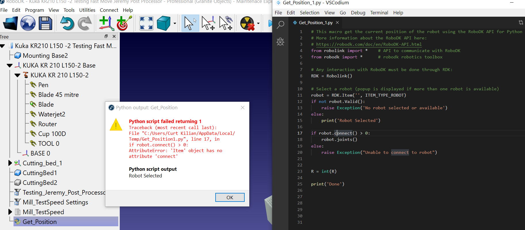

Hi Jeremy
In the meantime, I have created a "Get_Position" macro which I opened in RoboDK for offline programming.
My intention was to create a main program which would call the "Get_Position" macro first before any other programs.
However, when trying to "generate a program" from the Python macro, an Attribute Error appears.
Herewith a screenshot of the error and the Python code:
Please advise
Kind regards
Curt
Hi Curt,
Python is a Cap sensitive language, meaning you need to respect the letter capitalization.
You should use a capital C for "Connect" at line 17 and a capital J for "Joints" at line 18.
You could have just copy-pasted the code Albert sent you an avoid the typo ;).

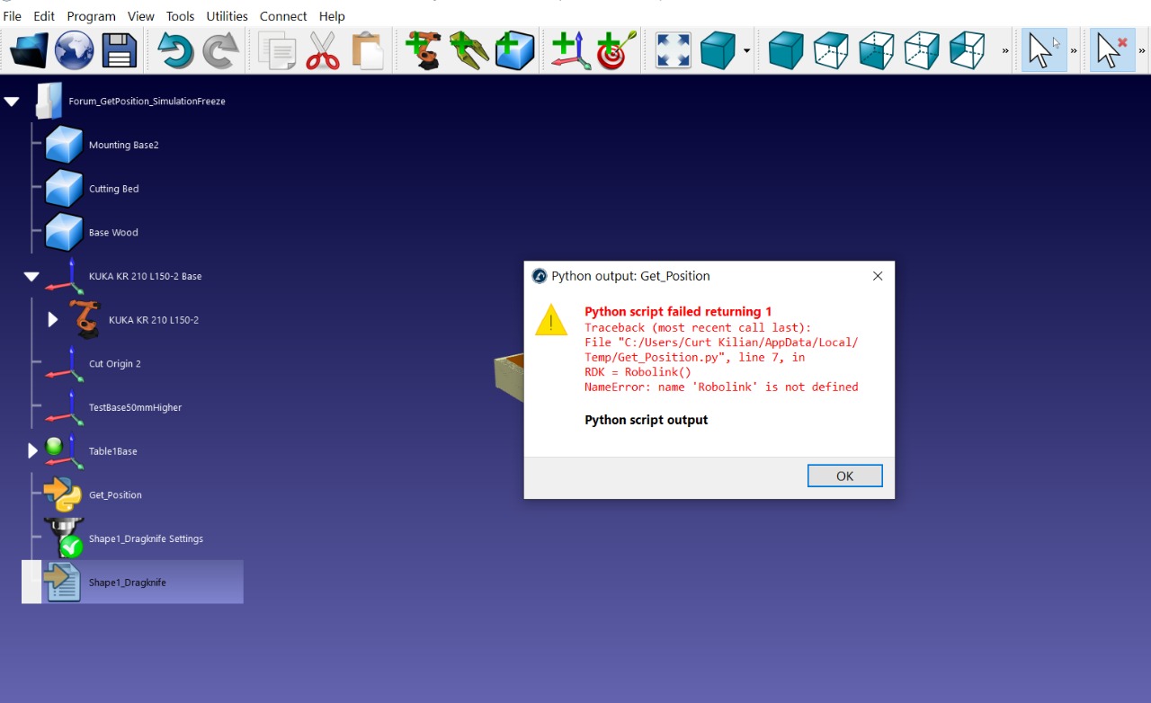

[attachment=2879]Hi Guys,
It has been a while since the last post!
To date, we have been selecting Get Position manually to run the Kuka Robot directly from RoboDk.
However, I have tried to apply the above advice you have given in the above posts.
When I try to SIMULATE the program, the following error message pops up: "Name Error: name 'Robolink' is not defined". Fortunately, if I click OK the simulation continues.
I assume that the cause of the error is that my laptop is not connected to the robot when I am trying to simulate first before running the program whilst connected? Is this assumption correct?
If RoboDK is connected to the Kuka robot whilst trying to run a simulation, will the error disappear?
My goal is to see the robot moving to the ACTUAL robot position on the simulation screen after connecting RoboDk to the robot and running the program by double-clicking it without selecting run and run on robot.
Please check out the attached RDK file to see if the macro is OK and set up correctly in program events.
Did you "import" Robolink in your python program.
There is no reason apart from that for the program to not recognize this library.
from robolink import *    # RoboDK API
from robodk import *      # Robot toolbox
RDK = Robolink()
