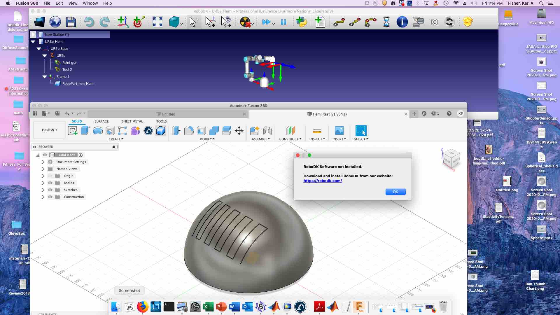

Fusion 306 Plugin Not seeing RoboDK
RoboDKTest.jpg    I am using the latest licensed version of RoboDK and Fusion 360. I have in stalled the RoboDK plugin into Fusion but every time i try to upload a model into RobotDK, Fusion 360 tells me I need to install RoboDK.  I have attached a screen shot. Help please
Karl
Hi Karl,
There's a new version of the RoboDK plug-in for Fusion 360 that fixes this issue. You can download it here:
https://robodk.com/downloads/plugins/Fus...plugin.zip
Let us know if you have issues with this plugin on Mac (we have not intensively tested this plugin on Mac).
