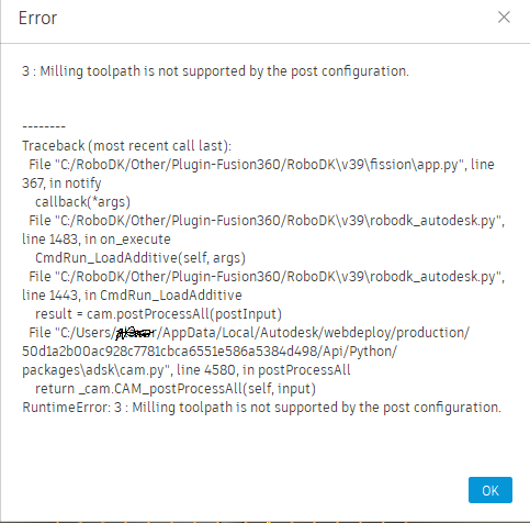

Fusion 360 API Error
Is there a new version of the plugin for fusion 360 coming out?

v39 is the current one I have.
I did get it to work.
Just can't use the Robodk button on the additive tab but when switching back to the mill tab then sending it to RoboDK it works great.
