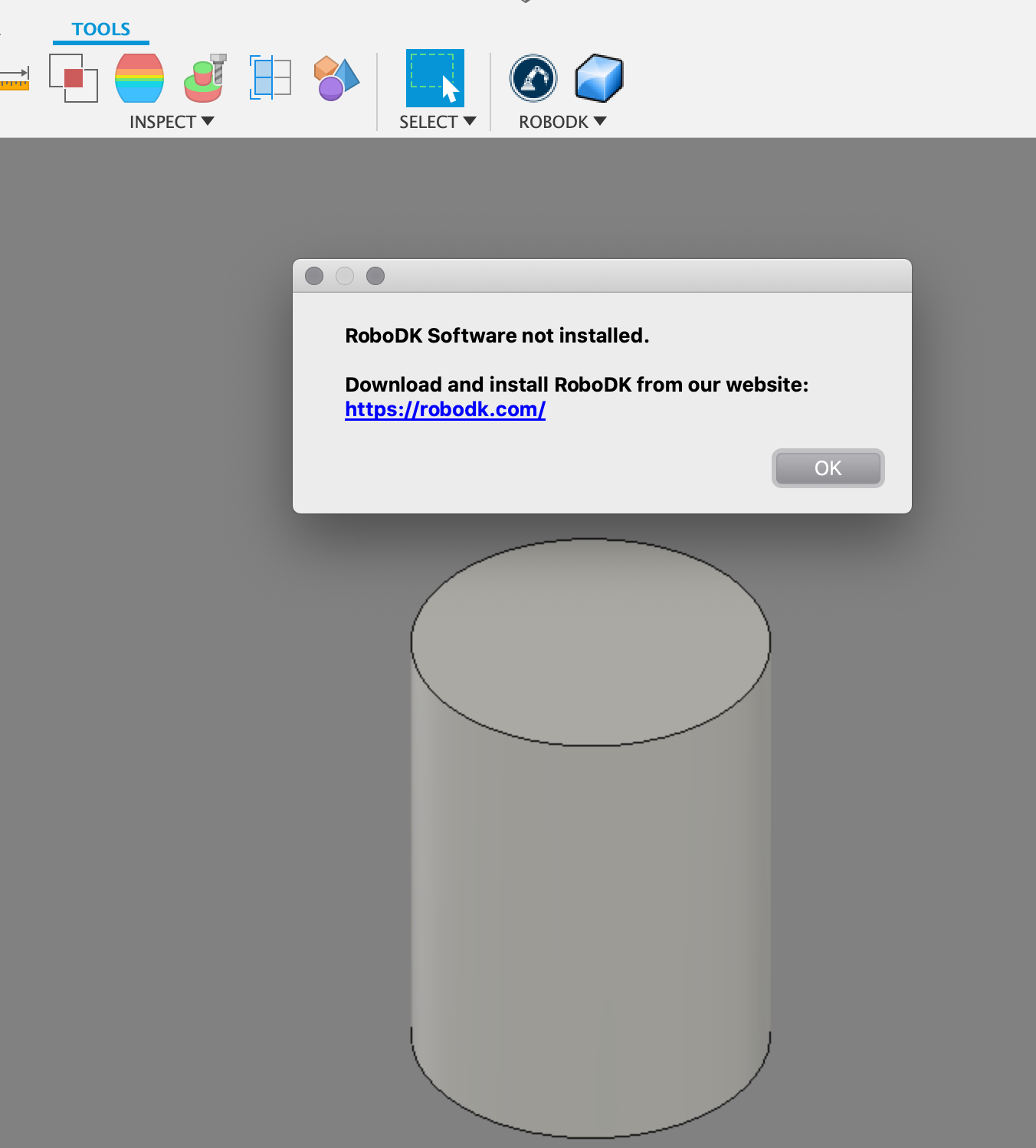

Fusion 360 Add-in |

Does it work if you start RoboDK manually?
I recommend you to install RoboDK for Mac here: ~/RoboDK/RoboDK.app/Contents/MacOS/RoboDK In that case, RoboDK will start automatically.

(04-24-2020, 08:19 PM)bewler Wrote: Hello, bewler, please tell me, how did you install the RoboDK plugin for Fusion360 in macOS? In the Fusion360 extension store I found a plugin for windows only
10-12-2021, 10:44 AM
You should use the STL format on Mac (I believe it is the default format used by the plugin).
You'll find the latest version of the RoboDK plugin for Autodesk Fusion 360 here: https://robodk.com/doc/en/Plugin-Fusion3...ualInstall It should be compatible with both Windows and Mac. Let me know if you have issues. |
